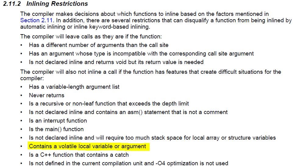

The inline function does not enter the ram area below.
The Inline function was created as an object.
This PI_run_parellel inline function(0x0008 7e70) deviated from the position of RamfuncsLoad(0x0008 3070 to 0x0008 3a60).
  • The function PI_run_parallel is not inlined.  It is yet another function in the .text section, and is allocated to same memory range as the other functions in .text.
    I do not know why it is not inlined.  For a function to be inlined at a particular call site, the full implementation of the function must be visible to the compiler at that point.  Is that the case?
    Thanks and regards,
    -George
  • Hi Gwangho,
    There are some restrictions for using Inline functions. As you mentioned, a volatile local variable or argument can not be used in inline function. All local variables and arguments should be non-volatile type. You can find more details in the compiler user's guide.
    Steve
