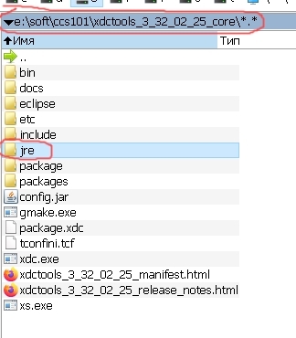

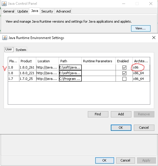

1. Download and install the 32-bit version of java.
2. Xdctools_X_XX_XX_XX_core in the folder create a subfolder named "jre".
3. Copy the folder with the installed 32-bit java to it.
