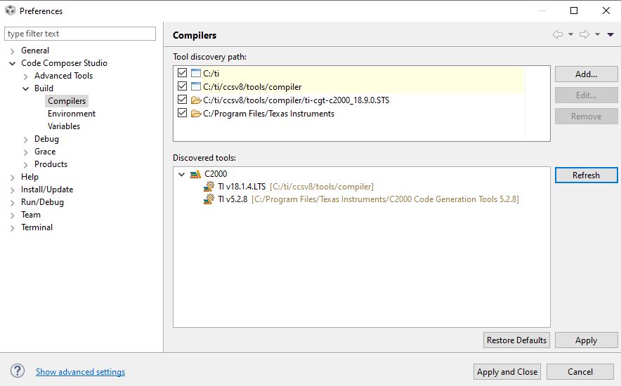

I am running CCS Version: 8.3.0.00009 on my Win 10 32-bit OS. I want to install a new C2000 Code Generation Tool to my CCS. I downloaded "ti_cgt_c2000_18.9.0.STS_windows_installer.exe" to my PC and installed it inside C:\ti.
After starting CCS the tool does not identify the new compiler:
Can you please tell me what is missing?

  • Hello Andreas.
    Can you try pressing the "Refresh" button? If that does not help, try adding the full path to the compiler (C:\ti\ti-cgt-c2000_18.9.0.STS) in the discovery path list and then press 'Refresh" again.
    ki
  • Hi Ki,
    I just did but it does not help, even when pressing "Refresh".
    Andreas

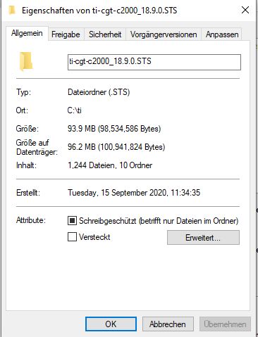

  • That is odd. I tried this out on my machine and it works fine.
    Can you check the contents of C:\ti\ti-cgt-c2000_18.9.0.STS and make sure it is not missing any contents?
  • As I already mentioned, the same CCS version works on my 2nd Laptop with a 64-bit OS without problems.
    I compared the folder properties on bioth machines, they look identical. This is from the working Laptop:
    This screenshot is from the non-working Laptop:
  • Can you remove your installation of the compiler and then use the CCS update manager (via 'Help -> Install Code Generation Compiler Tools') to download and install the compiler?
  • Hi Ki,
    I did but the behavior is the same. The CGT has just been installed in a different path:
       C:\ti\ccsv8\tools\compiler\ti-cgt-c2000_18.9.0.STS
    I added that path to the discovery window but still the Compiler wasn't added. But when I add the path "C:\Program Files\Texas Instruments" to the discovery settings, then CCS discovers properly the very old compiler version 5.2.8, which resides in that folder.

  • Hi Andreas,
    Would you be able to open Command window, navigate to 18.9 compiler directory (either C:/ti or inside CCS) then "cd" into "bin" directory and try to execute "cl2000 -version" there should be a listing showing version information for various C2000 code generation tools.
    If this showws a version listing, then would you be able to also attach workspace log file? It should be located in "YourWorkspaceDir\.metadata" directory and the file is called .log

  • Hi Martin,
    I guess you had the right idea.
    Let me translate from German to English:
    "cl2000.exe is not compatible with the current Windows version. Check the system information of the Computer and afterwards get in touch with the editor of the software."
    As I mentioned above, I am using a Win10 32-bit OS. But the "cl2000.exe -version" command works for the 18.1.4.LTS compiler version, which is also installed. This one seem to be compatible.
    Andreas
  • Hello Andreas,
    It is most likely a missing library that 18.9 compiler depends on. I am not an expert on compilers, but I'll find out how to get this working.
    Martin
  • Andreas,
    18.9.x.STS and 18.12.x.LTS were only released as 64-bit Windows applications.
    18.1.x.LTS was the last 32-bit windows.
    Greg
