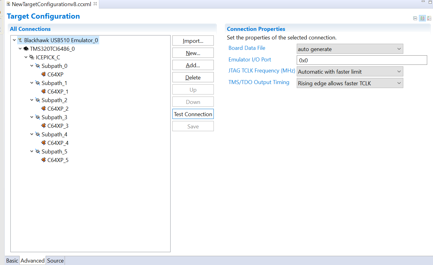

I am facing issue when I am trying to connect JTAG debugger using Blackhawk USB-510(BH-USB-510) emulator which is needed by our hardware(TCI6486) on CCSv8.3
We are using windows 10, 64bit environment.
When I am trying to connect the target I got below error:
"Error connecting to the target:
(Error -1265 @ 0x0)
Device ID is not recognized or is not supported by driver. Confirm device and debug probe configuration is correct, or update device driver.
(Emulation package 6.0.83.0)"
I'm attaching a screenshot of my target configuration and test connection result. Any help is much appreciated!
Thanks!

  • Hi Ki,
    Thank you for reply.
    We have only BH-USB-510 emulator to connect  TMS320TCI6486. We haven't BH-USB-510L with us and it is also discontinued by Blackhawk. Please refer this link https://www.blackhawk-dsp.com/store/12135f.html.
    We have checked our device configuration is correct as shown in screenshot. We have used same as we used for ccsv3.3.
    Is there any way, BH-USB-510 emulator can be used on CCSv8 and above?
    I tried with lowering down the TCLK speed, but issue persists.
    Thank You,
    Sachin

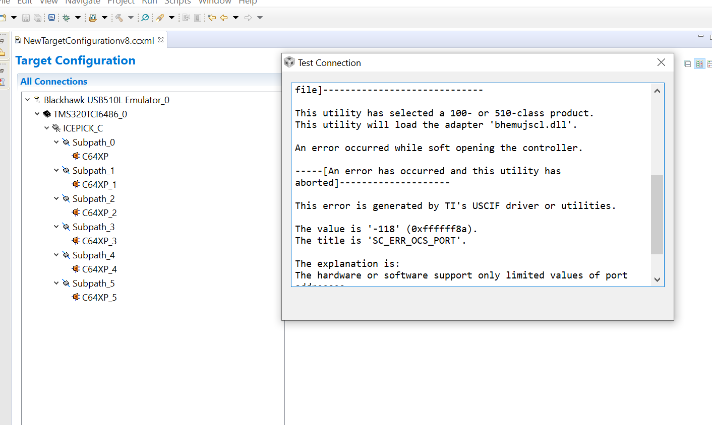

  • Hi Ki,
    I have tried with BH-USB-510L on TMS320TCI6486 and I got error in Test connection.
    Below are the Test connection result logs and screenshot for target configuration.
    Test connection result:
    [Start: Blackhawk USB510L Emulator_0]
    Execute the command:
    %ccs_base%/common/uscif/dbgjtag.exe -f %boarddatafile% -rv -o -F inform,logfile=yes -S pathlength -S integrity
    [Result]
    -----[Print the board config pathname(s)]------------------------------------
    C:\Users\ADMINI~1\AppData\Local\TEXASI~1\
    CCS\ti\2\0\BrdDat\testBoard.dat
    -----[Print the reset-command software log-file]-----------------------------
    This utility has selected a 100- or 510-class product.
    This utility will load the adapter 'bhemujscl.dll'.
    An error occurred while soft opening the controller.
    -----[An error has occurred and this utility has aborted]--------------------
    This error is generated by TI's USCIF driver or utilities.
    The value is '-118' (0xffffff8a).
    The title is 'SC_ERR_OCS_PORT'.
    The explanation is:
    The hardware or software support only limited values of port addresses.
    [End: Blackhawk USB510L Emulator_0]
    Target configuration(BH-USB-510L):
    Below screen shot is for target configuration that we did on ccs v3.3  with Blackhawk USB 510 emulator.
    (Please check third configuration from below screenshot)
    Thank You,
    Sachin
