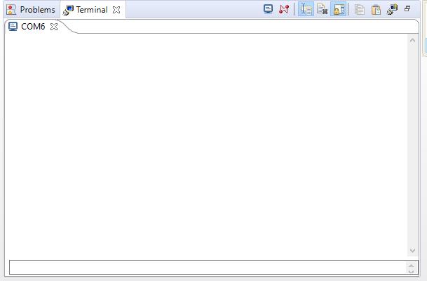

I saw this echo example and I am trying to use the CCS terminal to communicate with my MSP430G2553 processor. In the Launch Terminal window I only have 3 serial port options, COM1, COM3, and COM6. When I select COM1 or COM3, I am unable to do anything in the terminal window. When I select COM6 (see picture) CCS locks up when I try to send a command. Is there a setting I missed that is preventing me from communicating with the processor?

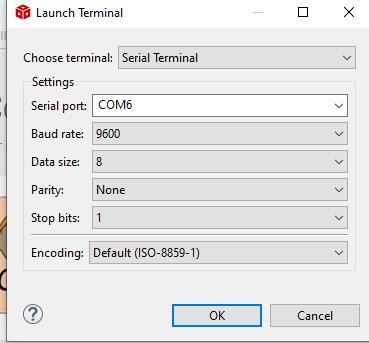

    CCS continues to lock up. I select View à Terminal and set up the terminal for serial communication on COM6 as shown on My Devices
    Once I select OK, the terminal window opens. If I click on the blank space or the command prompt and press any letter, CCS locks up.
    I downloaded PuTTY and I was unsuccessful in making a connection with my processor. I select COM6 with the same settings shown above and the command prompt doesn’t allow me to type any letters.
