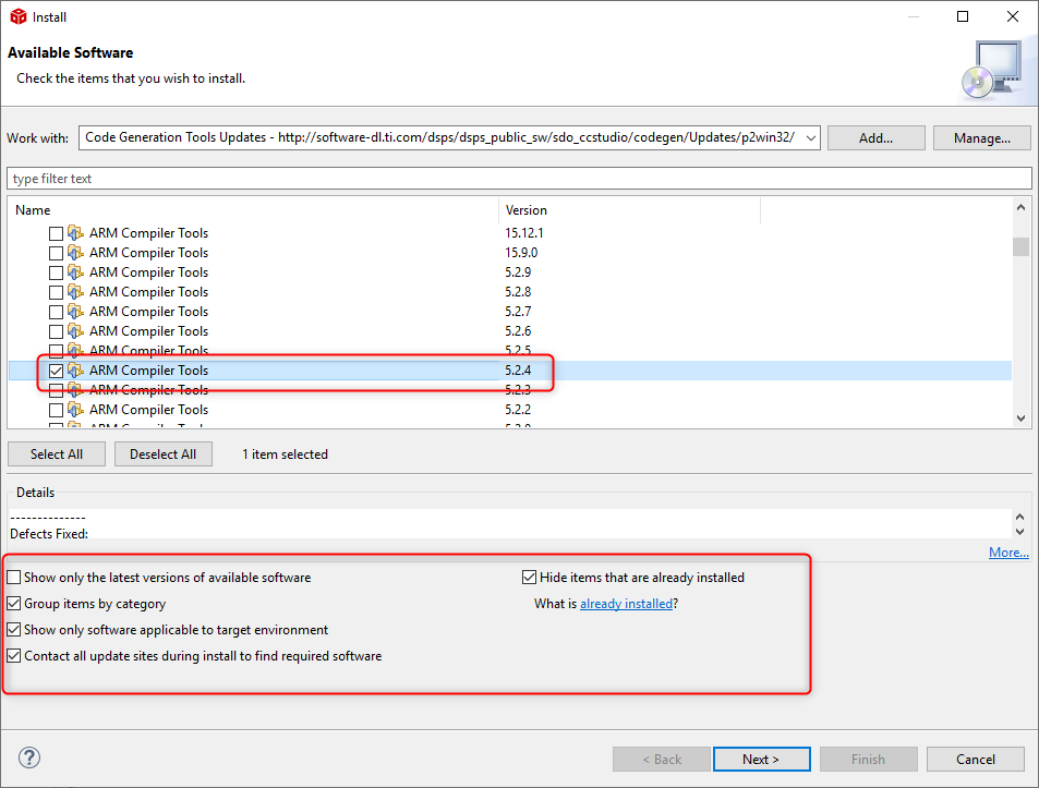

CCS/UCD3138: This project was created using a version of compiler that is not currently installed - 5.2.7 [ARM]:
Part Number: UCD3138
CCS  Version: 10.1.0.00010  ,   i  import the lab project  which get form the TI gov net , and  build the  project , it shows one error  "This project was created using a version of compiler that is not currently installed - 5.2.4 [ARM]"   ,  the compiler  is TI V5.2.4.  how to deal with it ?
    Go to: 'Help -> Install Code Generation Compiler Tools'
    Then in the dialog that appear, make sure the 'Show only the latest versions of available software' option is DISABLED. Then select the desired compiler version and press 'Next' to install it:
    ki
  • I have solve the problem in your ways ,thank a lot  Ki ,May you have a happy holiday!
