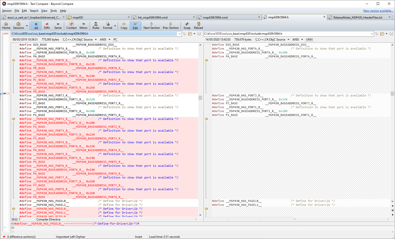

Having a look at the differences:Ki said:I did a diff of the files and one of the sections is different.
The main function in eusci_a_uart_ex1_loopbackAdvanced.c calls:Ki said:. I'm not sure if that is the cause of the error.
// Configure UART pins //Set P2.0 and P2.1 as Secondary Module Function Input. /* * Select Port 2d * Set Pin 0, 1 to input Secondary Module Function, (UCA0TXD/UCA0SIMO, UCA0RXD/UCA0SOMI). */ GPIO_setAsPeripheralModuleFunctionInputPin( GPIO_PORT_P2, GPIO_PIN0 + GPIO_PIN1, GPIO_SECONDARY_MODULE_FUNCTION );
Since the GPIO_PORT_TO_BASE[] entry for GPIO_PORT_P2 is 0xffff in the CCS 10 built version the above driver lib call will fail to set port 2 secondary module function, leading to the program not working.

I can follow up on your point and indeed the definitions in msp430fr5994.h for CCS930 and CCS1010 differ at this point:
CCS1010:
/***************************************************************************** DIO Registers *****************************************************************************/ #define __MSP430_HAS_DIO__ /* Definition to show that module is available */ #define __MSP430_BASEADDRESS_DIO__ 0x0200 #define DIO_BASE __MSP430_BASEADDRESS_DIO__ #define __MSP430_HAS_PORTA_R__ /* Definition to show that port is available */ #define __MSP430_BASEADDRESS_PORTA_R__ 0x200 #define PA_BASE __MSP430_BASEADDRESS_PORTA_R__ #define __MSP430_HAS_PORTJ_R__ /* Definition to show that port is available */ #define __MSP430_BASEADDRESS_PORTJ_R__ 0x320 #define PJ_BASE __MSP430_BASEADDRESS_PORTJ_R__ #define __MSP430_HAS_PORT1_R__ /* Definition to show that port is available */ #define __MSP430_BASEADDRESS_PORT1_R__ 0x200 #define P1_BASE __MSP430_BASEADDRESS_PORT1_R__ #define __MSP430_HAS_PASEL0__ /* Define for DriverLib */ #define __MSP430_HAS_PASEL1__ /* Define for DriverLib */ #define __MSP430_HAS_PJSEL0__ /* Define for DriverLib */ #define __MSP430_HAS_PJSEL1__ /* Define for DriverLib */ #define __MSP430_HAS_P1SEL0__ /* Define for DriverLib */ #define __MSP430_HAS_P1SEL1__ /* Define for DriverLib */
CCS930:
/***************************************************************************** DIO Registers *****************************************************************************/ #define __MSP430_HAS_DIO__ /* Definition to show that module is available */ #define __MSP430_BASEADDRESS_DIO__ 0x0200 #define DIO_BASE __MSP430_BASEADDRESS_DIO__ #define __MSP430_HAS_PORTA_R__ /* Definition to show that port is available */ #define __MSP430_BASEADDRESS_PORTA_R__ 0x200 #define PA_BASE __MSP430_BASEADDRESS_PORTA_R__ #define __MSP430_HAS_PORTB_R__ /* Definition to show that port is available */ #define __MSP430_BASEADDRESS_PORTB_R__ 0x220 #define PB_BASE __MSP430_BASEADDRESS_PORTB_R__ #define __MSP430_HAS_PORTC_R__ /* Definition to show that port is available */ #define __MSP430_BASEADDRESS_PORTC_R__ 0x240 #define PC_BASE __MSP430_BASEADDRESS_PORTC_R__ #define __MSP430_HAS_PORTD_R__ /* Definition to show that port is available */ #define __MSP430_BASEADDRESS_PORTD_R__ 0x260 #define PD_BASE __MSP430_BASEADDRESS_PORTD_R__ #define __MSP430_HAS_PORTJ_R__ /* Definition to show that port is available */ #define __MSP430_BASEADDRESS_PORTJ_R__ 0x320 #define PJ_BASE __MSP430_BASEADDRESS_PORTJ_R__ #define __MSP430_HAS_PORT1_R__ /* Definition to show that port is available */ #define __MSP430_BASEADDRESS_PORT1_R__ 0x200 #define P1_BASE __MSP430_BASEADDRESS_PORT1_R__ #define __MSP430_HAS_PORT2_R__ /* Definition to show that port is available */ #define __MSP430_BASEADDRESS_PORT2_R__ 0x200 #define P2_BASE __MSP430_BASEADDRESS_PORT2_R__ #define __MSP430_HAS_PORT3_R__ /* Definition to show that port is available */ #define __MSP430_BASEADDRESS_PORT3_R__ 0x220 #define P3_BASE __MSP430_BASEADDRESS_PORT3_R__ #define __MSP430_HAS_PORT4_R__ /* Definition to show that port is available */ #define __MSP430_BASEADDRESS_PORT4_R__ 0x220 #define P4_BASE __MSP430_BASEADDRESS_PORT4_R__ #define __MSP430_HAS_PORT5_R__ /* Definition to show that port is available */ #define __MSP430_BASEADDRESS_PORT5_R__ 0x240 #define P5_BASE __MSP430_BASEADDRESS_PORT5_R__ #define __MSP430_HAS_PORT6_R__ /* Definition to show that port is available */ #define __MSP430_BASEADDRESS_PORT6_R__ 0x240 #define P6_BASE __MSP430_BASEADDRESS_PORT6_R__ #define __MSP430_HAS_PORT7_R__ /* Definition to show that port is available */ #define __MSP430_BASEADDRESS_PORT7_R__ 0x260 #define P7_BASE __MSP430_BASEADDRESS_PORT7_R__ #define __MSP430_HAS_PORT8_R__ /* Definition to show that port is available */ #define __MSP430_BASEADDRESS_PORT8_R__ 0x260 #define P8_BASE __MSP430_BASEADDRESS_PORT8_R__ #define __MSP430_HAS_PASEL0__ /* Define for DriverLib */ #define __MSP430_HAS_PASEL1__ /* Define for DriverLib */ #define __MSP430_HAS_PBSEL0__ /* Define for DriverLib */ #define __MSP430_HAS_PBSEL1__ /* Define for DriverLib */ #define __MSP430_HAS_PCSEL0__ /* Define for DriverLib */ #define __MSP430_HAS_PCSEL1__ /* Define for DriverLib */ #define __MSP430_HAS_PDSEL0__ /* Define for DriverLib */ #define __MSP430_HAS_PDSEL1__ /* Define for DriverLib */ #define __MSP430_HAS_PJSEL0__ /* Define for DriverLib */ #define __MSP430_HAS_PJSEL1__ /* Define for DriverLib */ #define __MSP430_HAS_P1SEL0__ /* Define for DriverLib */ #define __MSP430_HAS_P2SEL0__ /* Define for DriverLib */ #define __MSP430_HAS_P1SEL1__ /* Define for DriverLib */ #define __MSP430_HAS_P2SEL1__ /* Define for DriverLib */ #define __MSP430_HAS_P4SEL0__ /* Define for DriverLib */ #define __MSP430_HAS_P3SEL0__ /* Define for DriverLib */ #define __MSP430_HAS_P3SEL1__ /* Define for DriverLib */ #define __MSP430_HAS_P4SEL1__ /* Define for DriverLib */ #define __MSP430_HAS_P5SEL0__ /* Define for DriverLib */ #define __MSP430_HAS_P6SEL0__ /* Define for DriverLib */ #define __MSP430_HAS_P5SEL1__ /* Define for DriverLib */ #define __MSP430_HAS_P6SEL1__ /* Define for DriverLib */ #define __MSP430_HAS_P7SEL0__ /* Define for DriverLib */ #define __MSP430_HAS_P8SEL0__ /* Define for DriverLib */ #define __MSP430_HAS_P7SEL1__ /* Define for DriverLib */ #define __MSP430_HAS_P8SEL1__ /* Define for DriverLib */

Simply copying the DIO Register Settings Part from msp430fr5994.h in CCS930 over to CCS1010 resolves the problem.
The same goes for the msp430fr59941.h in CCS1010.

I see the same difference:Lukas Lischke said:I can follow up on your point and indeed the definitions in msp430fr5994.h for CCS930 and CCS1010 differ at this point
For the above:
Looking at ccs\ccs_base\msp430\ReleaseNotes_MSP430_HeaderFiles.txt suspect there was an error made in msp430fr5994.h when was modified for the following change in Build 1.210 (CCS):
Bug fixes: ---------- - Removed invalid IO ports from several MSP430FRxx devices
As a quick-fix I think that would work and then performing a re-build of the project. Probably worth backing up the original file first.Lukas Lischke said:Can I safely copy the content of the msp430fr5994.h from CCS930 over to CCS1010?
Perhaps in CCS could revert to a previous version of com.ti.msp430.support_files.feature.group component. Ki should hopefully know if that is possible.Lukas Lischke said:Would that be a valid fix in your eyes or is there a more elegant solution?
