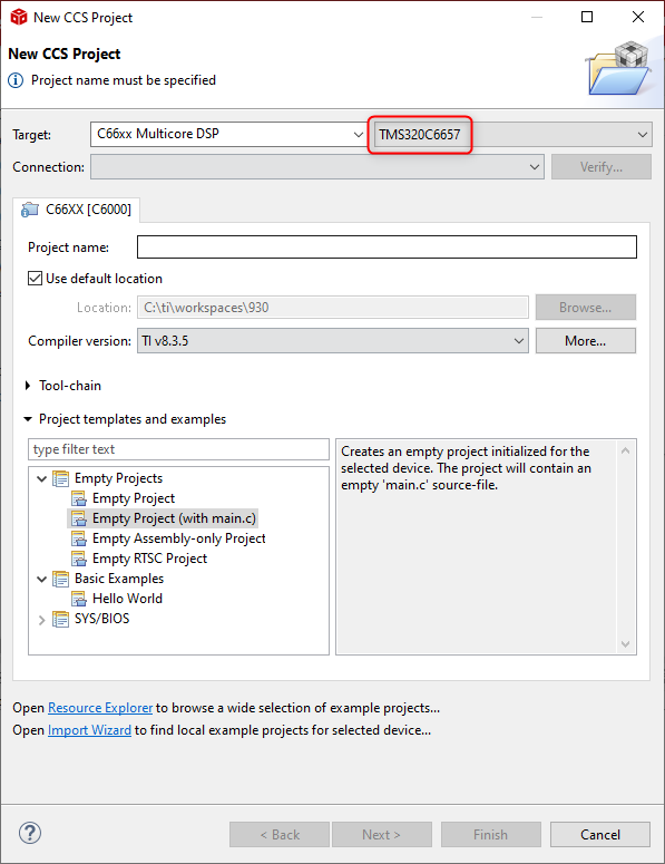

1) Under the Project properties / General / Project tab, the device correctly shows 'Family' as C6000, but I do not see TMDSEVM6657LS in the 'Variant' pulldown list. How do I add support for this Evaluation Module to CCS? The latest and greatest CCS v9.3.0 should already know about the TMDSEVM6657LS.
    Please use the below variant:

  • Ki,
    TMDSEVM6657LS (Issue 1)
    I found, through much experimentation, that Windows found and registered the XDS200 connection when I attached the mini-USB connector only when there was no power to the main board. The Mezzanine mini-USB XDS200 is the correct connection. Issue resolved.
    CCS v9.3.0 (Issue 1,2)
    The XDS200 connection verifies successful.
    The TMDSEVM6657LS evaluation board does not show up even though I installed all relevant packages during CCS v9.3.0 install. I selected TMS320C56657 and that seems to work with the eval board as far as GEL files and connectivity (although I don't know how my project is supposed to know about DRAM capacity and other peripherals on the eval board). I'm declaring issues resolved.
