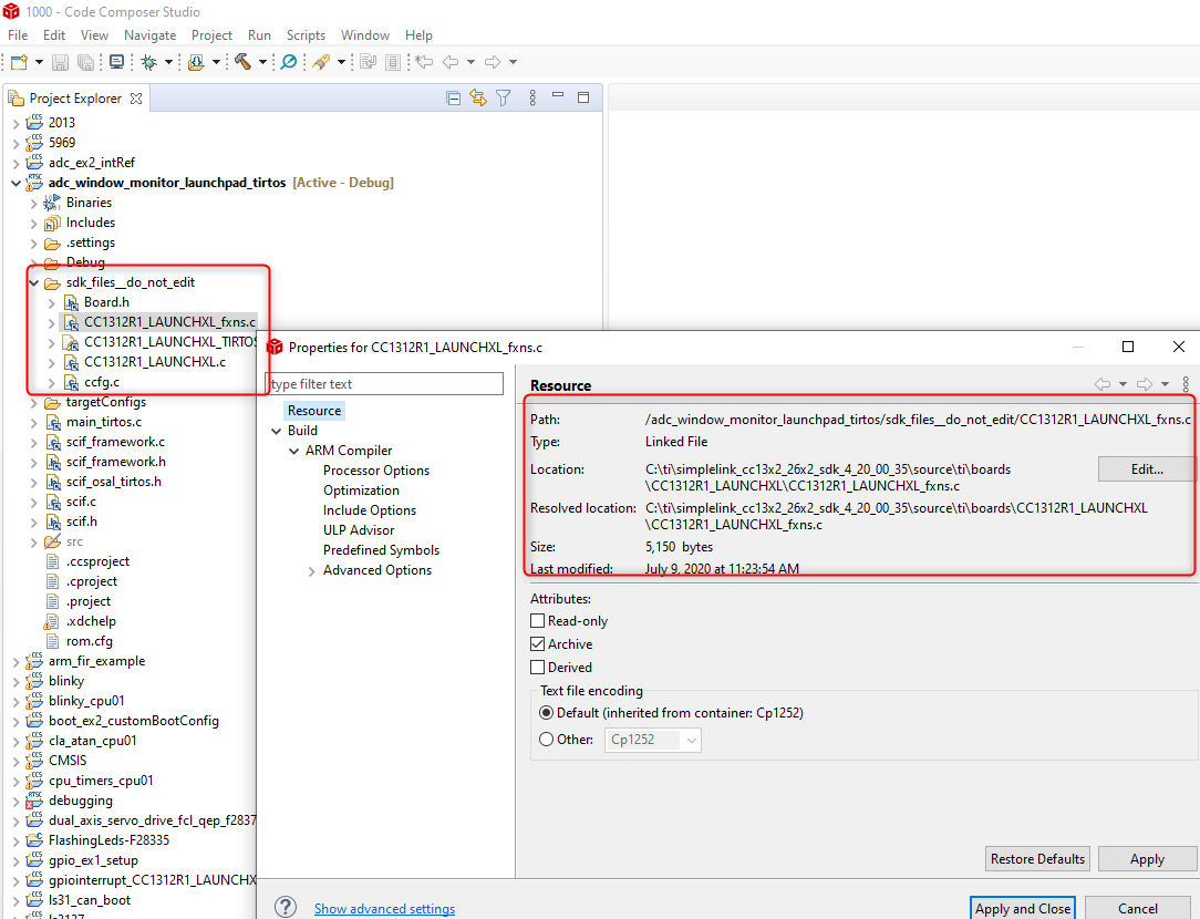

  • Can you post a screenshot of the project in the Project Explorer view? And please expand the "sdk_files__do_not_edit" folder and bring up the properties for one of the files (right-click on it and select "Properties" in the context menu)
    ki
  • Here is the requested picture:
    Alex
  • I noticed I have the most recent version of the SDK (4.30.00.54 (05 Oct 2020)) and the file path is for version 4.20.00.35 (30 Jun 2020). I am not able to locate the CC1352R1_LAUNCHXL_fxns.c file in the location for version 4.30.00.54. I also notices you are using the fxns.c file for 1312R1 while I am using the 1352R1 if that makes a difference. I even searched windows for that file and I could not find it. What suggestions do you have to help resolve this issue?
    Alex
  • Some of the linked source files has broken links (the yellow exclamation mark icon).
    I'm not sure what is going on here. DO you have multiple versions of the SDK installed? Based on the build output you provided, the project is using 4.20.00.35, which is the latest version of the SDK I see available (at least publicly).
    Please make sure you have a valid version of 4.20.00.35 installed. The project is looking for files in it and cannot find them
  • There are two newer versions than 4.20.00.35.
    4.20.01.04 was released 14 Aug 2020 and 4.30.00.54 was released 05 Oct 2020, as shown on this website:
    I had the most recent version installed (4.30.00.54 05 Oct 2020). When I installed 4.20.00.35, I stopped getting any errors, but there was still one warning that says "This module is depreciated". I currently have more than one version of the SDK installed, as seen in the picture below. Would you recommend deleting the two versions that are not 4.20.00.35?
    Alex

    Alex
    No, it is perfectly fine to have keep multiple versions of the SDK. As for the warning, it is a deprecation message. It is likely ok for now, though in the future it may cause issues.
