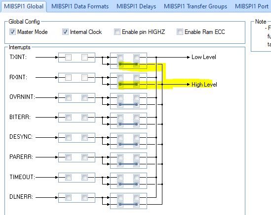

    1. If the VIM channel for MibSPI1 (channel 12, or channel 26) is checked, the HALCOGen will generate the MibSPI1 ISR automatically. There are two interrupt lines, one each for Level 0 (or High level)  and Level 1 (or low level). Level 0 has higher priority than level 1.
    2. Select the interrupt level (high or low) for MibSPI TX and RX interrupt:
    3. The ISR generated by HALCOGen is located at the end of mibspi.c

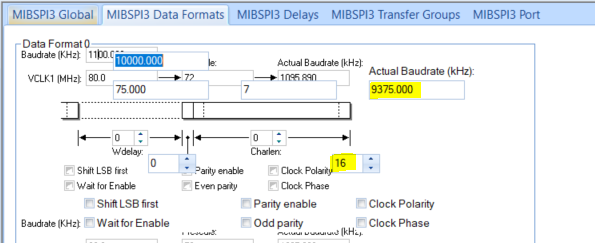

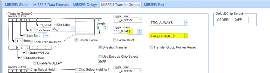

  • Hello QJ Wang,
    Thank you for your reply . I've configured mibspi3 (mibspiREG3) as per your suggestion , still function "mibspiGroupNotification" not getting executed. below are snapshot for interrupt configurations:
    1) Interrupt selection -> High Level
    2) Data length and clock setting .
    3) Transfer group 0 setting
    4) Interrupt Setting
    5) Code flow
    I'm not able to understand which setting I've missed . Kindly guide on the same .

  • Please enable TG0 notification:
    mibspiEnableGroupNotification(mibspiREG3,0,0);
