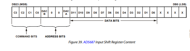

I've interfaced AD5687 DAC (12 bit ) IC to Hercules RM57L843 through mibspi3 interface. In order to update DAC output , its count need to be send in 24bit command format mentioned below :
In Halcogen there is setting for 'Charlen', I've configured charlen as 8 bits. Now I've confusion , as below mentioned function require buffer pointer data type is as uint16_t  *
void mibspiSetData(mibspiBASE_t *mibspi, uint32 group, uint16 * data)
while sending transfer group , I'm not able to understand how to incarporate 24 bit command in transmit buffer which is of type 'uint16_t' instead of 'uint8_t'

    1. Configure charlen as 8 bits
    2. Set the CSHOLD bit: the nCS signal will not be deactivated until the next control field is loaded with new chip select information
    To use the APIs generated by HALCoGen, you need to re-org your data:
    uint32_t Data = 0x1A2B3C;  //24 bit data
    unit16_t txData[3] ={0};
    txData[0] = data & 0x00FF;
    txData[1] = data>>8 & 0x00FF;
    txData[2] = data>>16 & 0x00FF;
    mibspiSetData(mibspiREG1, 1, &txdata[0])
