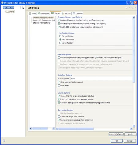

  • That is really strange. Could you check the stack and heap sizes for your project (should be under Build Properties->C/C++ Build->Linker->Basic Options)? My defaults are set to stack size = 256 and no heap. Try increasing these sizes in your project to see if they make a difference. I'm not sure what else could be causing your code to get lost in the startup code especially since the same project works for me.
    I am also attaching a screenshot of my debug properties to compare with yours.

    Ive tried changing heap and stack sizes. Debug settings are the same as yours. Check out the attached map file and see if you can see any problems. Could you also send me your .map file and I could look too.
