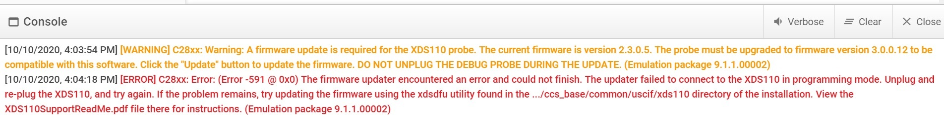

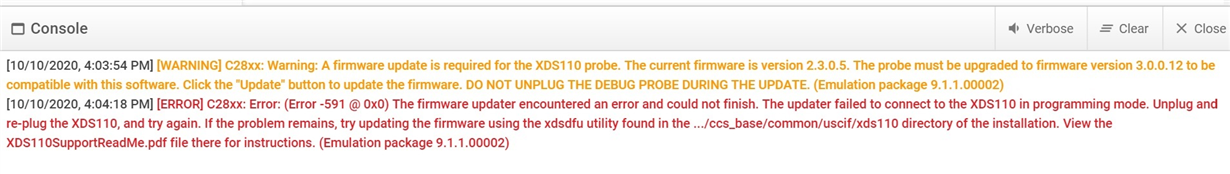

CCS/TMDSEMU110-U: UniFlash issues an error -591
Part Number: TMDSEMU110-U
Though my PC had setting same as other PC, an error occurred.
Can it be settled if I update the firmware?
The procedure of working is as follows.
1. Install "UniFlash" in a PC.
2. Install "XDS Emulation Software" in a PC.
3. I connect "XDS110" to a PC, and I write a file of ".out" in target.
4. -591 error occurrence.
