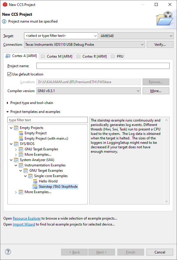

  • Hello Ki,
    Project -->New CCS project:
    I would be happy to run it on any core A53 or  R5F.
    Kalman

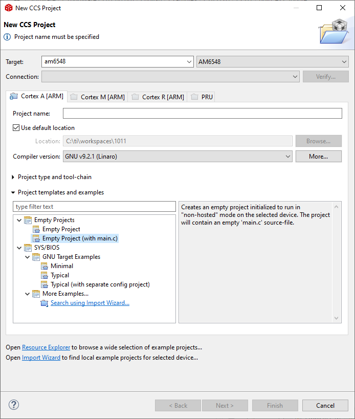

  • Interesting. I do not see it with my installation:
    I must be missing a dependency of some sort. I'll need to investigate further
    ki
    Ok, after I installed the Processor SDK v7, I see the template option available.
    I can reproduce the errors. Basically there are a lot of options in the project that are not supported for the CPU (A53). The template "as-is" is not supported for the A53.
    However, I was able to build the example successfully for the Cortex-R.
    In any case, I would approach with caution. Custom System Analyzer implementations has been deprecated in support. The level of support we can give for it is minimal.

  • Kalman Budai said:
    As I see there are unknown compiler switches. I have updated the original GCC 9.2.1 (2019 q4 major) to 9.3.1 (2020 q2 update), but it did not solve the compilation issues.
    Yes I noticed the problem also. As mentioned in my previous post, the A53 is not supported by that template example.
