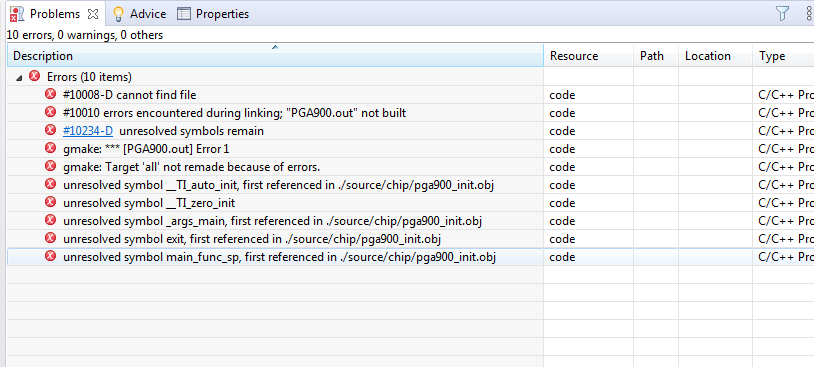

Part Number: PGA900
Hi Sir
I already did the steps in this thread
but I still have these errors

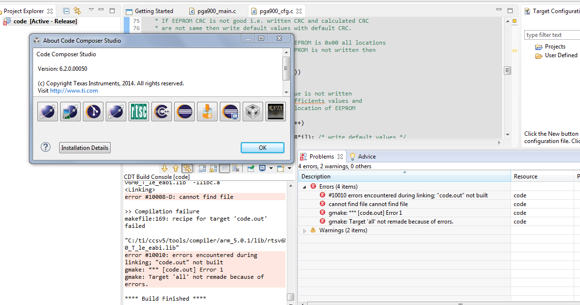

Hi Ihab,
It looks like you have a compiler version that should be compatible, but have you also made sure that the runtime support library is linked? Are you using an absolute file path or did you copy the rtsv6M0_T_le_eabi.lib file into the compiler directory so that it will be automatically selected?
Hi Scott
I just checked the linker directory and it worked well. Maybe it was because of the direction of the slash in the directory.
