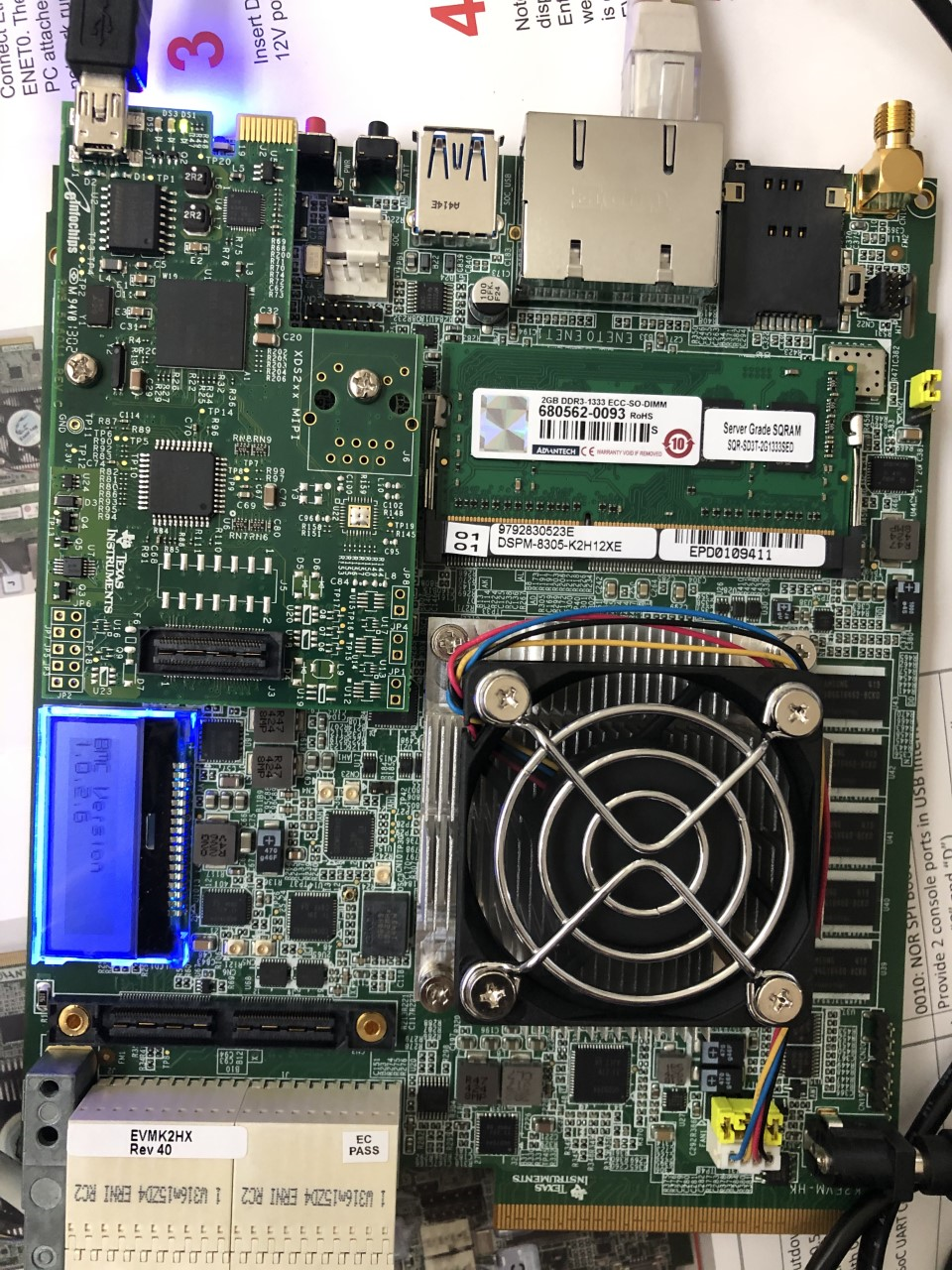

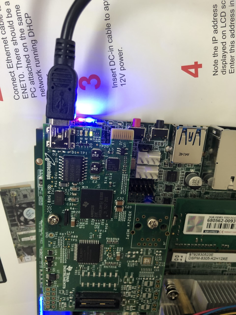

We have a K2HX Evaluation Module. It was just bought and delivered to our labs a few days ago. Its "run out of the box" demonstration Matrix App Launcher v2p1 is not launching because it's ethernet ENET0 is not working. We would like to create and run a simple demo application using the XDS200 emulator port to check its functionality. So I followed the steps in:
EVMK2HX Hardware Setup Connect to EVM2H Using CCS via XDS2XX USB Onboard Debug Probe via MIPI connection.
software-dl.ti.com/.../EVMK2H_Hardware_Setup.html
and on that page:
For Debugging over emulator use "No Boot/Sleep" Setting as shown below:
and
On Board XDS200 emulator (XDS2XX MIPI) its current firmware:

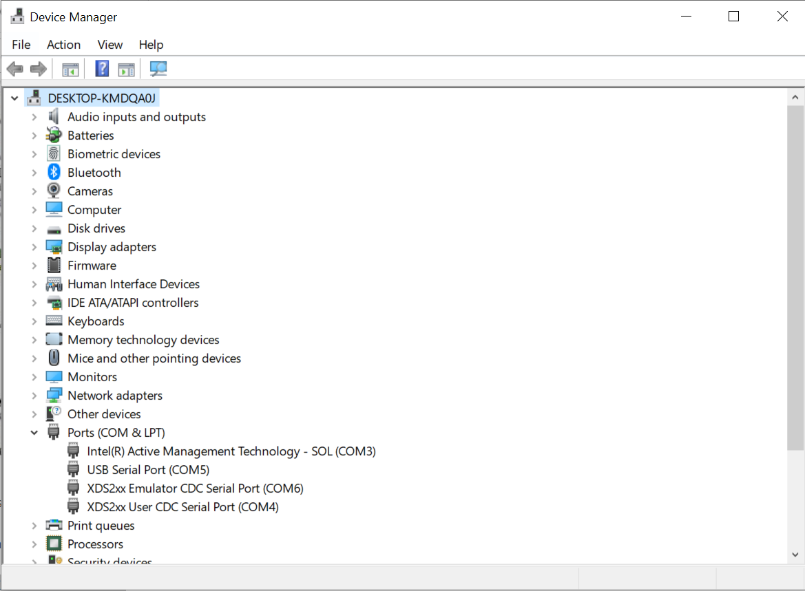

When I look at the Device Manager for my PC running Windows, I see that the devices attached through a USB port correctly.

    The board is powered by 12V,7A power adapter which comes in the box. We assume the manufacturer supports the power properly. I also tried to plug the second USB mini cable in (if it wants all usb ports externally powered for debug reasons) which goes to base EVM board but no success.
    EVMK2HX Evaluation Module comes with its Mezzanine XDS2XX Onboard USB preassembled by the manufacturer(TI/Advantech/eInfochips). I followed the Quick Start Guide "out of the box" and TI online guidelines for this product. As you said XDS200 is fine but TVRef Pin is wrong and voltage doesn't exist there. How would we proceed as an end-user to run out-of-the-box demonstration then?
    What would be the solution to get it running? Shall we contact with your reseller Mouser UK to obtain replacement of the module? Because it's bought recently to develop our project and see the feasibility of C66AK2H14 for further projects. Now it's causing a delay which effects our project deadline.

    For k2H EVM:
    • 12V, 7A adaptor is sufficient
    • The USB on the board is for UART, the USB on the mezzanine card is for XDS200 JTAG
    • The TI link for how to setup EVM HW is correct
    • Things you can try is to replace with a shorter USB cable for JTAG, and unplug/plug then tighten the Mezzanine card in case the contact to the EVM is loose
    • The BMC 1.0.2.6 is the latest, EVM Rev 4.0 is also the latest
    • The EVM should shipped with the latest UCD
    • Please try to see if you can update the BMC and UCD following the same HW setup link, we know some EVM has JTAG failure, but resolved after updating the BMC and UCD
    If that still doesn't work, please contact the vendor for a replacement. I have an older K2H EVM and tested JTAG connection without problem.
