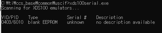

When I tried to debug the TMS320F28335 board through the XDS100v2 Emulator in CCS, a 151 error occurred.
After checking with xds100serial.exe, it looks like a blank EEPROM.
Seeing other related articles, it seems that FTDI is programmed using FT Prog.. I wonder if it is an accurate solution.
What should I do to fix my problem?

Han SeungJae said:After checking with xds100serial.exe, it looks like a blank EEPROM.
Please see the below document:
https://software-dl.ti.com/ccs/esd/documents/xdsdebugprobes/files/XDS100.pdf
At the end of page 14, see section "How do iI reprogram the VID/PID EEPROM if it has not been programmed correctly?"
