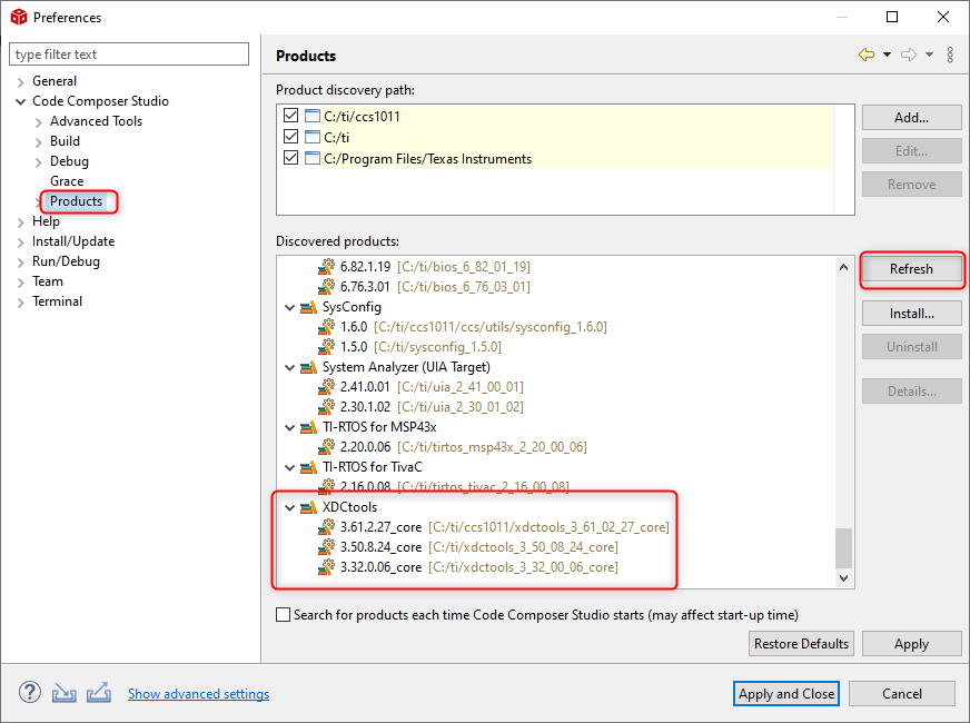

I have checked the list of discovered products and saw a listing for XDCtools.
But i wondered why there was still “No XDCtools,equivalent to specified version ‘3.51.999’ “when i imported a CSS project and i can not see XDCtools in 'Build'.
But i wondered why there was still “No XDCtools,equivalent to specified version ‘3.51.999’ “when i imported a CSS project and i can not see XDCtools in 'Build'.Will this affect the compilation and debugging of my project?
It is a bit of a misleading warning. I don't think it should impact the building of the project.
