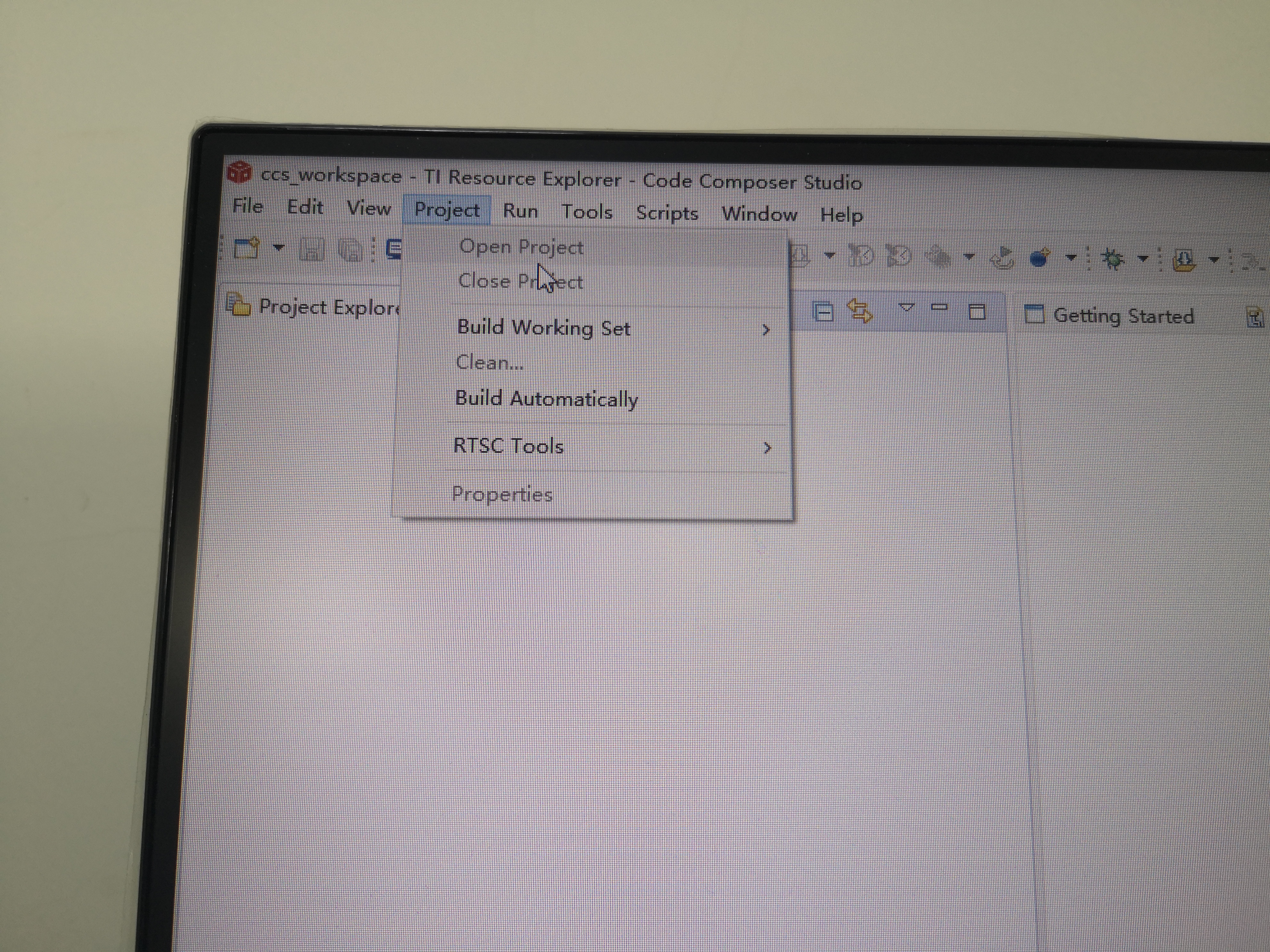

The day before yesterday, i cannot open ccs resource explorer. And it's not my first time opening it. What's more, 'import project' should be found in project menu, but it cannot be found, too.
I don't want to reinstall the appliccation, so is there anyway to solve my problem?
thank you!
Based upon your screenshot the CCS Debug perspective is open, which doesn't have the 'import project' option in the project menu. If you switch to the CCS Edit perspective the 'import project' option should re-appear.cheng cao said:What's more, 'import project' should be found in project menu, but it cannot be found, too.
Not sure if this also explains the problem with the resource explorer not opening.
Chester is correct regarding the perspective.
As for Resource Explorer, please try some of the suggestions in the Troubleshooting Guide:
https://software-dl.ti.com/ccs/esd/documents/users_guide/ccs_troubleshooting.html#resource-explorer
