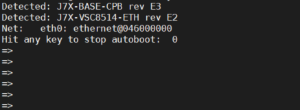

3)Copy the image to the SD card to start and stop at the command line of UBOOT

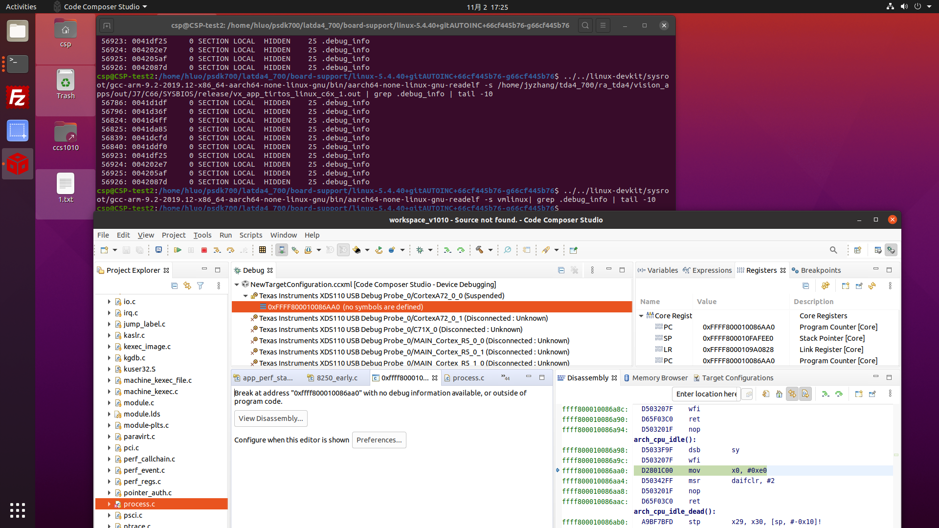

    Your debugging method is feasible and I have tried it.
    Although I am able to see the symbols and able to program breakpoints,but because the source code is not recognized, it is very inconvenient for me to debug.
    So I enabled the debug_info config, compiled kernel,and loaded symbols from the vmlinux.
    When I try to debug one step using F5,CCS always prompt that Break at address with no debug information available.So I still can't debug the source cod conveniently.

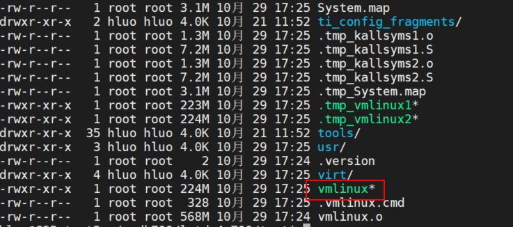

    I used readelf to check vmlinux but I didn't find the debug_info or debug_line keyword:
    My question is why I cannot locate the source code after enabling the debug_info config.What can I do to generate the correct vmlinux with debugging information

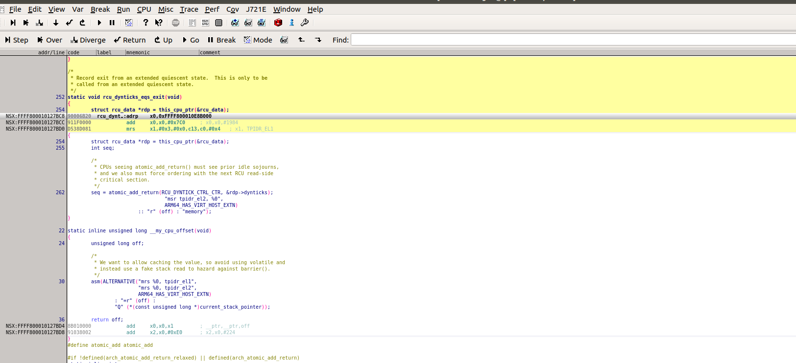

    I am able to do source level debug using lauterbach/trace32 debugger. Just for your reference. I believe this is what you intend
    to do using CCS:
    I will check with the team internally on CCS.
    By any chance you have lauterbach/trace32?
    Keerthy

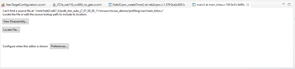

  • Hi Hao.luo,
    In CCS once you have loaded the vmlinux. You need to locate the source code path:
    For ex see below:
    Click on locate file and then point to the right source code path for that file. CCS will start showing you the source code. This is the method on CCS.
