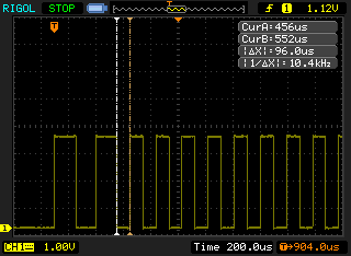

    Please advise, and Thank you so much!
  • I did the same procedure as before, and my scope reports a sample rate of about 278ksps. At that rate 100 samples is about 360 usec, roughly 1/3rd of a 1kHz sine wave. It would be much less of a 0.5Hz sine wave, so I don't think you'd see the multi-cycle curves that are shown at that imgur link.
    Briefly put: I suspect you're not testing what you think you are. Are you sure the (new) code downloaded?
    [Edit: Unsolicited; You're not actually waiting for the ADC to finish before capturing the results. I think this works by accident due to the other things you're doing in the loop, but it's something to watch out for.]
    I wasn't able to hook up the CCS graphing, so I pasted the 1kHz results into Open Office, and it shows a fairly smooth curve.
  • Thank You!
    So it seems the error I had was due to using breakpoints for graphing as once I removed breakpoints and just used excel to graph the val[ ] array i got consistent values with a sine wave. Thank You very much!
    https://imgur.com/a/Tl4mGys
