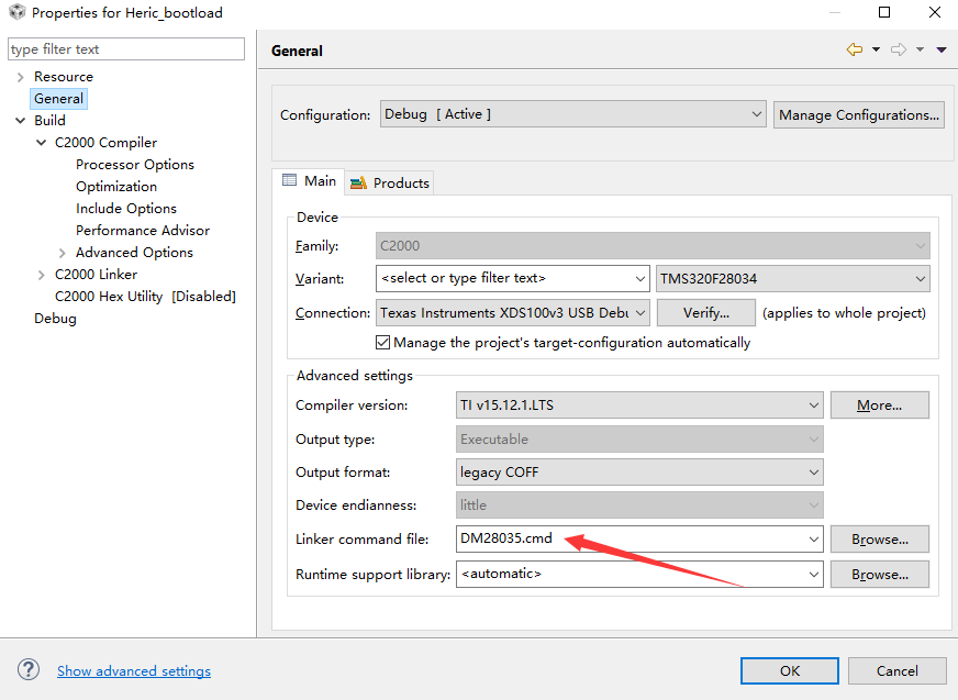

I have a question about bin document created by ccs7.3.
I add "${CCE_INSTALL_ROOT}/utils/tiobj2bin/tiobj2bin" "${BuildArtifactFileName}" "${BuildArtifactFileBaseName}.bin" "${CG_TOOL_ROOT}/bin/ofd2000" "${CG_TOOL_ROOT}/bin/hex2000" "${CCE_INSTALL_ROOT}/utils/tiobj2bin/mkhex4bin" & "${CG_TOOL_HEX}" -i "${BuildArtifactFileName}" -o "${BuildArtifactFileBaseName}.hex" -order MS -romwidth 32" in Post-build steps. And add CMD path in Linker command file shown in picture below.
But, there are difference between bin and hex shown in below.I mean the data are not same.Please see 100.7z.
https://e2e.ti.com/cfs-file/__key/communityserver-discussions-components-files/81/8524.100.7z
When I do not add cmd path, bin and hex seems same. Please see 101.7z.
https://e2e.ti.com/cfs-file/__key/communityserver-discussions-components-files/81/6866.101.7z
In this way, I could not debug project by ccs. In other words, I could not connect chip shown in picture below. And console shown like these "C28xx: Loader: One or more sections of your program falls into a memory region that is not writable. These regions will not actually be written to the target. Check your linker configuration and/or memory map."
Here are the cmd document. Please see DM28035.7z.
https://e2e.ti.com/cfs-file/__key/communityserver-discussions-components-files/81/DM28035.7z
So, how should I solve this problem? Looking forward for your reply.
  • The .bin file in the first attachment starts with many bytes filled with 0.  I presume avoiding this block of 0 will fix the problem.  I don't know what causes it.  To investigate this problem, please attach the file Heric_bootload.out (the .out file created by the linker) to your next post.  Just like you did with your other attachments, put it in a .7z file.

    I think the problem starts with this line in the linker command file DM28035.cmd ...
        DataBuff           : > RAML2       PAGE = 1 , fill = 0x00
    Remove the fill = 0x00.  Instead, change your system start code to zero out this range of memory.  That fill changes DataBuff from an uninitialized section to an initialized section.  That's probably not what you want.  I cannot test whether this change will fix the problem.  But I'm confident it will.
