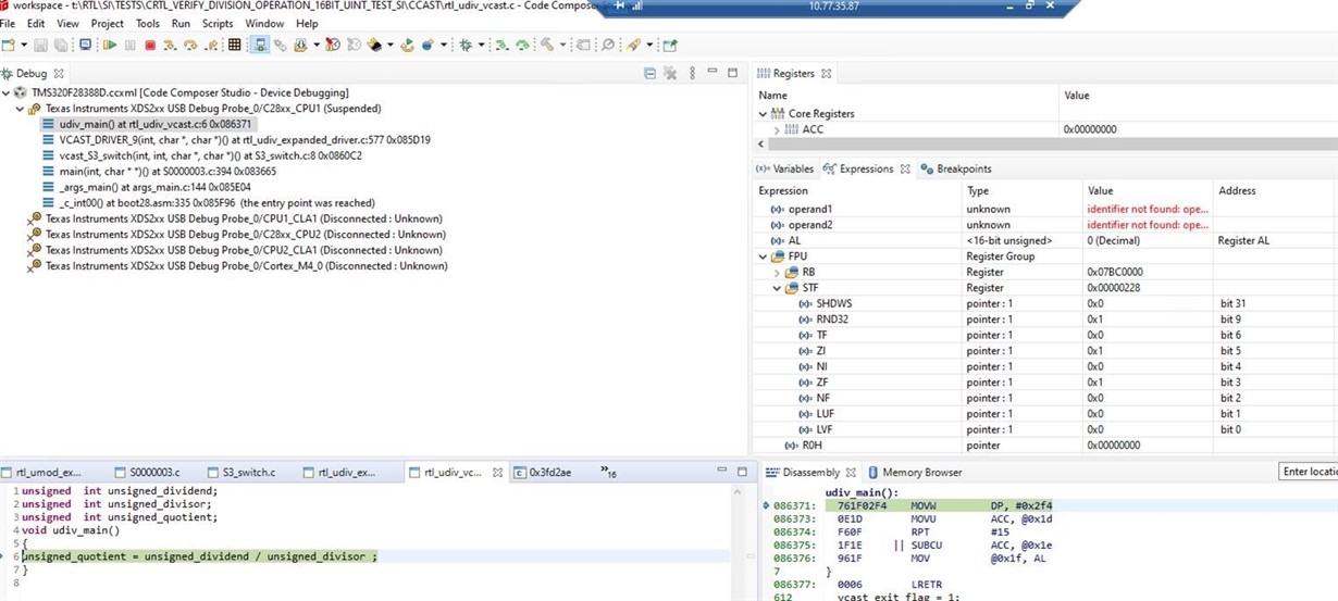

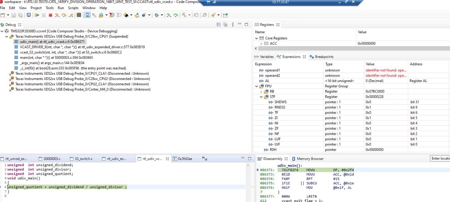

  • Hi George,
    As per the above question, the problem I have mention should is the opposite, U$$MOD doesn't displays  __c28xabi_modu  but  U$MOD dispays  __c28xabi_modu  in disassembly.
    Please refer to the screenshot below:
    if you see the diaasmebly, the UDIV_main() is displaying the UDIV instead of  __c28xabi_divu. Why?
    It is not in the case of U$$MOD, please refer to another screenshot:
    The difference is nothing between the  __c28xabi_modu and U$$MOD, but for documentation purpose we require these aliases to be correctly displayed while checking in disassembly.
    As there is no difference in the code of U$$MOD and U$DIV, but why the alias name is not displaying for U$DIV.
    Hope you got my point clearly this time!
    Regard,
    Gurusha
  • The function udiv_main does not make any function calls.  It computes the division expression with the instructions RPT || SUBCU.  The function umod_main calls the function __c28xabi_modu.
    Thanks and regards,
    -George
  • Hi George,
    No, if you see dissembly, udvi_main() is also called.
    That means it is calling some udiv function and performing the division operation.
    Please try testing on your side if it is feasible for you.
    Thanks & regards,
    Gurusha
  • A better way to see the compiler generated assembly code is with the build option --src_interlist.  It causes the compiler to put the assembly code in a file with the same name as the source file, with the extension changed to .asm.  Add --src_interlist, build rtl_udiv_vcast.c, then inspect rtl_udiv_vcast.asm.  The instruction used for a function call is LCR.  You will see the function udiv_main does not contain any LCR instructions.
    Thanks and regards,
    -George
