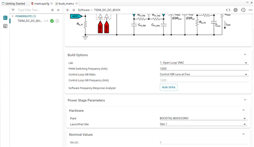

I am trying to modify the PWM frequency of the TIDM-DC-DC-Buck reference design to suit my project specification (Buck converter). The logical place seems to change the value in the main.syscfg UI highlighted in the following image. Following the 'lab 1' for open loop application of the reference design, I was able to make it work at the default switching 200 kHz. However, I can't change that for anything higher than 500 kHz. Any frequency above 500 kHz when you write 0.25 to the duty cycle, the continuous "expression" window would not update any data and nothing is output it from the pins (confirmed through oscilloscope).
Is there a software limitation on how fast this reference design can switch? How can I change the PWM frequency from the default 200kHz to 1MHz?

P.S. All of the codes are left as default. Attached is the project if it helps. Thank you in advance
