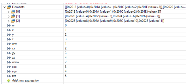

Hi Compiler team,
Using MSP430 compiler V20.2.2.LTS, optimization = off, MSP430FR2633
I have an interesting problem that is most likely me doing something wrong.  I have an application where I use a 2D array of pointers to structures that hold measurement values and an algorithm navigates through the array to read measurements.  I simulate that with the code shown.  What I am seeing is the first row is de-referenced correctly, but subsequent rows are not.  I have included a simple example in main.c that demonstrates the issue.
Also, in my sensor struct if I use assignment  .pElements = Elements, I get a compiler warning, where as if I use what is shown in the code below, no warning, but in either case the results are wrong.

    w = pSensor->pElements[0][0].value;     // = 0 correct
    x = pSensor->pElements[0][1].value;     // = 1 correct
    y = pSensor->pElements[0][2].value;     // = 2 correct
    z = pSensor->pElements[0][3].value;     // = 3 correct
    ww = pSensor->pElements[1][0].value;    // = 1 not correct, should be 4
    xx = pSensor->pElements[1][1].value;    // = 2 not correct, should be 5
    yy = pSensor->pElements[1][2].value;    // = 3 not correct, should be 6
    zz = pSensor->pElements[1][3].value;    // = 4 not correct, should be 7
    www = pSensor->pElements[2][0].value;    // = 2 not correct, should be 8
    xxx = pSensor->pElements[2][1].value;    // = 3 not correct, should be 9
    yyy = pSensor->pElements[2][2].value;    // = 4 not correct, should be 10
    zzz = pSensor->pElements[2][3].value;    // = 5 not correct, should be 11
    while(1);
When I run the code, I can then stop and examine the values.  You can see starting with variable ww, the values are not correct.
Here is a memory dump of these variables
