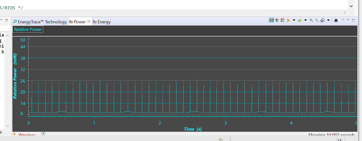

I am using the MSP432P401R and the CC2640R2F Launchpads in a Simple Application Processor/Simple Network Processor pair.
My issue is that I am unable to change the advertising interval on the SAP side to 1 sec (1600=1000ms)Steps I have taken:
Changed DEFAULT_ADVERTISING_INTERVAL in application_processor.h to 1600. This did not work as it does in standalone cc2640r2f applications because DEFAULT_ADVERTISING_INTERVAL is never used in the SAP application.
I also tried to update the advertising interval using SAP_setParam. However, this did not work either.
uint16_t advInt = DEFAULT_ADVERTISING_INTERVAL;
SAP_setParam(SAP_PARAM_ADV, SAP_GEN_DISC_ADV_INT_MIN, sizeof(advInt), (uint8_t *) advInt);
SAP_setParam(SAP_PARAM_ADV, SAP_GEN_DISC_ADV_INT_MAX, sizeof(advInt), (uint8_t *) advInt);
  • Hi Casey,
    Could you try changing the DEFAULT_ADVERTISING_INTERVAL in simple_np_gap.c in the simple_np example?
    Alec
  • Thank you for your response Alec.
    I modified the Simple_np project and changed the default advertisment interval but it still appears that it hasnt changed.
    This is the power plot from energytrace. every 100ms is a pulse. I would expect this to be every second.
    -Casey

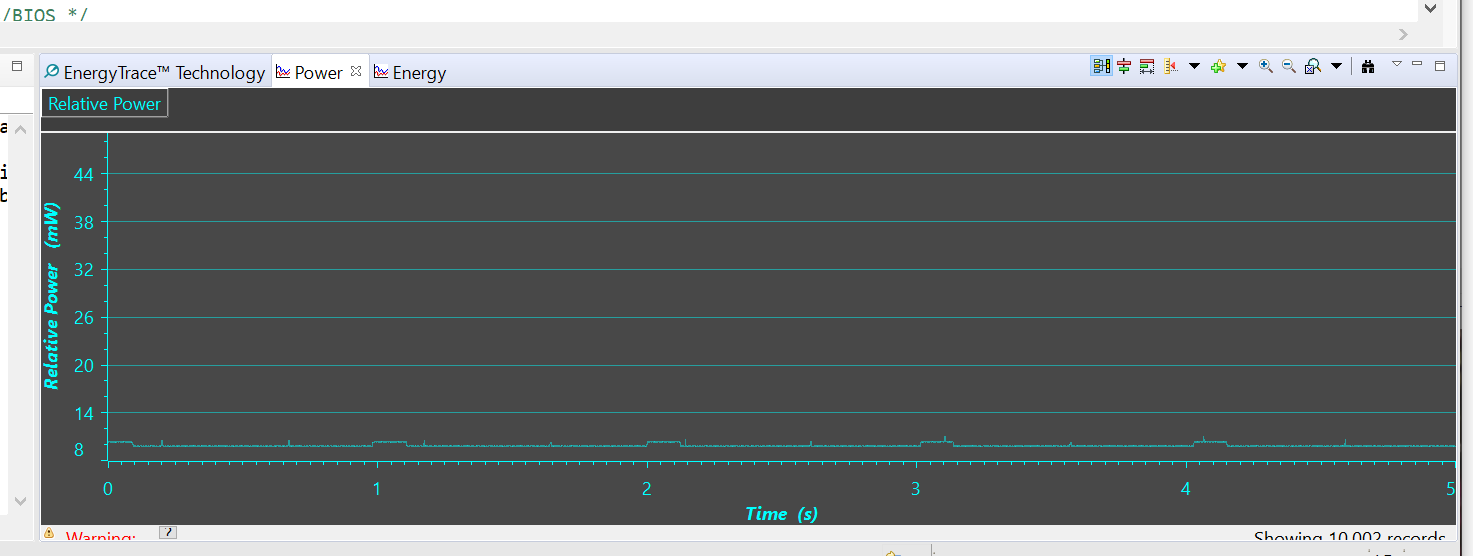

  • Hi Casey,
    As a quick debugging exercise, could you try disabling advertising entirely in the simple_np project and check to see that these pulses go away? The easiest way to do it would be by modifying the lines where you do the following, and make sure advertEnabled is false.
    GAPRole_SetParameter(GAPROLE_ADVERT_ENABLED, sizeof(uint8_t), &advertEnabled);
    Let me know what results you see after testing this, and we can work from there.
    Alec
  • Hi Alec,
    Thank you for your response. I followed your instructions and disabled advertising. Here is what energytrace shows now.
  • To clarify, I modified this in the application processor firmware on the MSP432 not the cc2640R2F.
