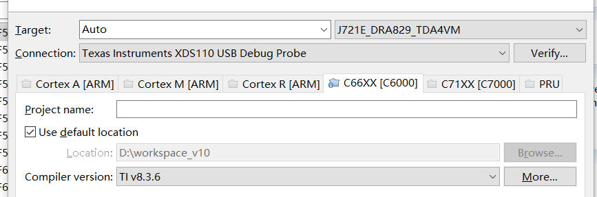

How to choose the selection when I create a TDA4 project?
Cortex A(ARM) , Cortex M(ARM), Cortex R(ARM), C66xx(C6000), C71xx(C7000) or PRU?
What's the meaning of them?
The TDA4 is a multi-core device with many different types of CPUs. When creating a new TDA4 project, you are given the option to select which CPU type to create a project for. For example, if you want to create a TDA4 project for the C66x CPU core, select the "C66xx (C6000)" tab like you did in your screenshot.
Note that you can only create a project on a per CPU type basis.
