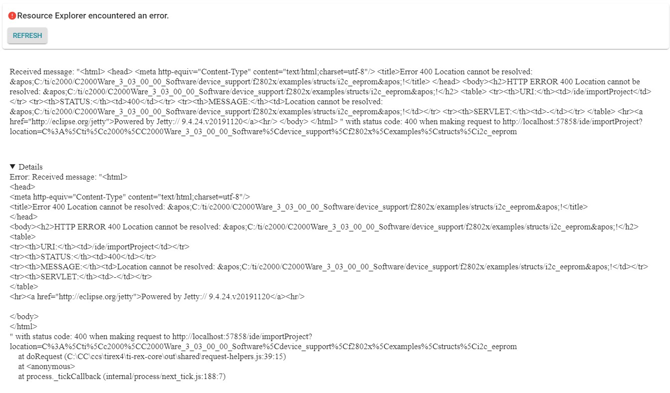

I am attempting to install the i2c_eeprom example program for the LAUNCHXL-F28027F board, and Code Composer keeps throwing this error message.
I did find a forum post about this problem from a few months ago. Unfortunately, neither one of the solutions they proposed worked. I have confirmed that my .metadata folder is named correctly and even did a completely fresh install of C2000Ware (and confirmed that the .metadata folder was still correct) and I am still getting the error.
Any assistance would be appreciated.
  • Hi Gabriel,
    I assume that you installed C2000Ware by manually downloading it from the ti.com webpage and installing it yourself. This can cause issues with Resource Explorer and C2000Ware due to a mismatch in a folder name. The workaround is to either install C2000Ware via Resource Explorer from CCS, or rename the folder from C:\ti\c2000\C2000Ware_3_03_00_00 to C:\ti\c2000\C2000Ware_3_03_00_00_Software
