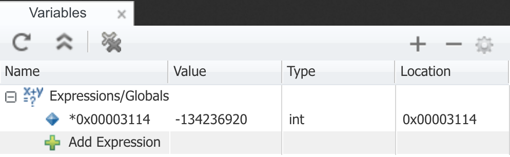

  • Adrian,
    There is no memory browser in the simplified debug interface that CCS Cloud provides at this time.  Alternatively you can enter an address in the variables view to see the value located in memory at that address.
    If a full memory view is required then CCS Desktop would be the best option.
