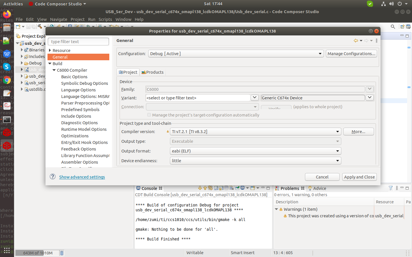

  • Hello Ki
    Thank you for your quick reply
    I just checked that compiler version v7.2.9 appear in project window and I selected that but still no changes
    I just want to know that can this code will be compiled and run on OMAPl138 because I am getting the .out file
    i have attached screenshot of my project window,I am using CCS v.10.1.0 or shall i go for lower version of ccs
    shubham
  • In your screenshot, I can see that you are still configured for compiler version 8.3.2. See if 7.2.9 is available in the dropdown.
    In any case, I tried building the same example with compiler version 8.3.2 with CCS 10.1.0. It builds fine.
    Try 'Project -> Clean' first, then try building the project again.
    ki
