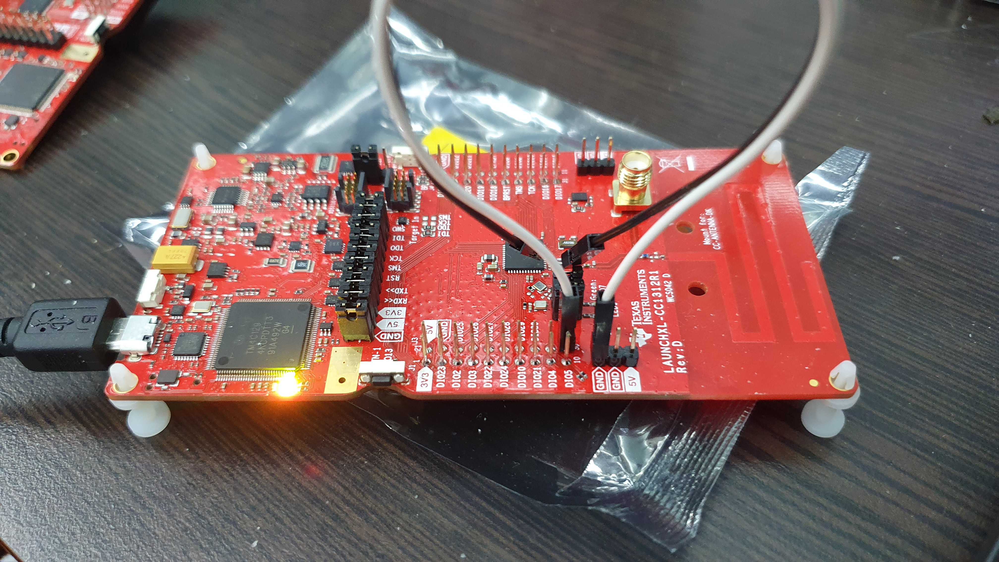

    In order to avoid any custom board hardware issue, I did a simple test on CC1312R1 launchpad.
    I can reproduce the issue.
    Some key source code as below. I connected a jump line from DIO1 to GND.
    After power up, I remove the GND end (i.e. create rising edge), the interrupt did NOT assert,
    (I set a breakpoint in the callback 'dip_debug_cb'. It was not entered.)
    However, if the initial condition is disconnected (disconnect DIO1 from GND), I can catch
    the first interrupt (i.e. falling edge) when I connected the jump line after power up.

  • Hi Elin,
    In the  later reproduce on cc1312 launchpad, I imported the sensor project which was shown 'sensor_CC1312R1_LAUNCHXL_tirtos_ccs'
    in CCS.
    I patched little,  defining a new button by syscfg tool, adding below code in ssf.c module.
    Button_Params bparams;
    Button_Params_init(&bparams);
    Button_open(CONFIG_BUTTON_0, dip_debug_cb, &bparams);
    void dip_debug_cb(Button_Handle _buttonHandle, Button_EventMask _buttonEvents)
    CUI_statusLinePrintf(ssfCuiHndl, sensorStatusLine, "buttonEvents=%x",
    _buttonEvents);

  • Hi Elin,
    No, I'm not familiar with ROV.
    From my massive test, I think INT_BOTH_EDGES equals to INT_FALLING in behavior.
    Please take a closer look at your side.
    There were a couple of successful trial, but I think it was caused by bounce.
    That is, the falling edge of bounce 'helps'  to assert the interrupt.
    The rising edge does NOT assert the interrupt in the first trigger after boot up.
    BR
    Adam
