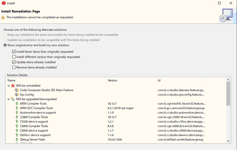

Cannot complete the install because one or more required items could not be found.
Software being installed: SysConfig Data Update for 9.3 1.0.1 (com.ti.ccstudio.sysconfigdataupdate.feature.group 1.0.1)
Missing requirement: SysConfig Data Update for 9.3 1.0.1 (com.ti.ccstudio.sysconfigdataupdate.feature.group 1.0.1) requires 'org. eclipse.equinox.p2.iu; com.ti.ccstudio.sysconfig.feature.group [1.3.1030,1.3.1030]' but it could not be found

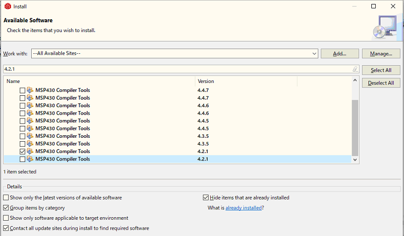

  • Hi ki,
    Thank you for your reply.
    It seems that the customer had chosen to use only the MSP430 compiler. The following are the details of the selection and error screens.

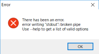

    Also, after installing CCSv9.3.0 on my PC, I proceeded to install MSP430 compiler v4.2.1 without any problems. However, when I rebooted, I got the following error message and could not start. I have run the CCS installation twice, and both times the error occurred. Also, the compiler was not in the Tool folder.

    The second screenshot seems to indicate that multiple updates were attempted to be installed.
    This is an odd error that I only saw once before - also after an attempted update. the root cause was never identified.
    I had engineering take a look at the error message and they were not familiar with it. Can you try using the eclipse launcher to launch CCS?
    <CCS INSTALL DIR>\ccs\eclipse\eclipse.exe
    If that does not help, I'm afraid you may need to do what the last customer did - completely remove and then reinstall CCS. If you do choose to reinstall, I can provide a way to obtain the MSP430 v4.2.1 compiler without using the update mechanism.
