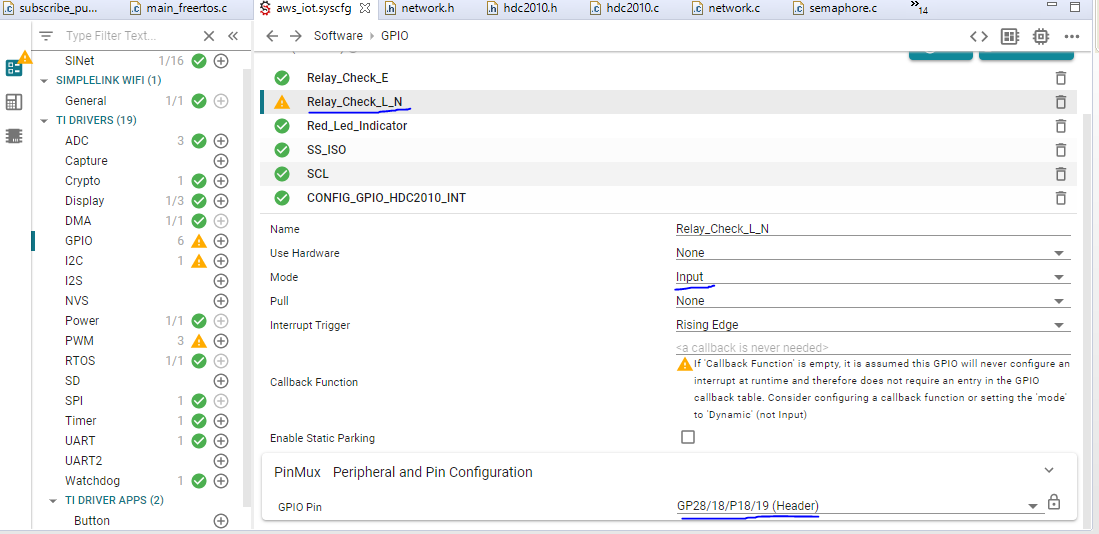

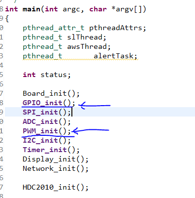

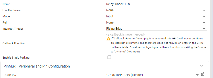

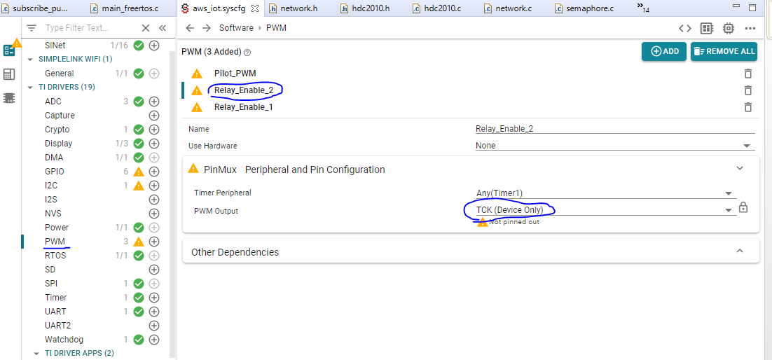

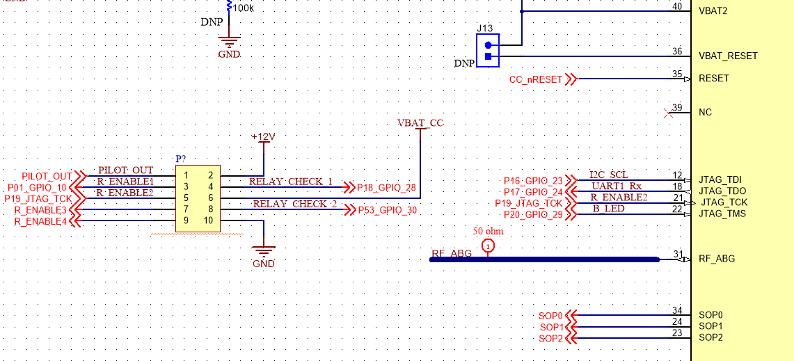

Hi TI,
whenever we are using TCK pin as PWM, and defining GPIO28 as input pin , this gpio is not taking any input, while changing PWM with another pin, gpio28 is working properly. please let us know why it is happening. please help out us to resolve this issue.
gpio28 in sysconfig pic
pwm sysconfig pic
Br,
Sarju Bhatnagar

        /* Relay_Check_E */
        GPIOCC32XX_GPIO_30 | GPIO_CFG_OUT_STD | GPIO_CFG_OUT_STR_MED | GPIO_CFG_OUT_LOW,
        /* Relay_Check_L_N */
        GPIOCC32XX_GPIO_28 | GPIO_CFG_IN_NOPULL | GPIO_CFG_IN_INT_RISING,
        /* Red_Led_Indicator */
        GPIOCC32XX_GPIO_25 | GPIO_CFG_IN_PD | GPIO_CFG_IN_INT_NONE,
        /* SS_ISO */
        GPIOCC32XX_GPIO_17 | GPIO_CFG_OUT_STD | GPIO_CFG_OUT_STR_MED | GPIO_CFG_OUT_HIGH,
        /* CONFIG_GPIO_HDC2010_INT */
        GPIOCC32XX_GPIO_06 | GPIO_CFG_IN_PU | GPIO_CFG_IN_INT_FALLING,

    const PWMTimerCC32XX_HWAttrsV2 pwmTimerCC32XXHWAttrs[CONFIG_PWM_COUNT] = {
        /* Pilot_PWM */
            .pwmPin = PWMTimerCC32XX_PIN_64, /* 64 */
        /* Relay_Enable_2 */
            .pwmPin = PWMTimerCC32XX_PIN_19, /* 19 */
        /* Relay_Enable_1 */
            .pwmPin = PWMTimerCC32XX_PIN_01, /* 01 */

    For GPIO :
     GPIO_init(); declared inside main. and pin settings in sysconfig are
    that's it ,what i am doing for GPIO initialization, After that simply i am trying to read GPIO input using
           if(GPIO_read(Relay_Check_L_N))
                IOT_INFO("Relay L N : HIGH");
            else
                IOT_INFO("Relay L N : LOW");
    to check whether GP28 is HIGH or LOW, but it is not changing it's state, it is always low. while giving high 3.3V to it. And this is happening when TCK is used as pwm.
    once TCK is replaced with another pwm pin, GPIO28 is responding well.
    here is the setting details for PWM:
    inside main
        PWM_init();
    function to open PWM
    static void Relay_Enable_2_Initializer()
        /* Period and duty in microseconds */
        uint16_t pwmPeriod = 1000;    //3000; -> 1000 ms for 1KHz frequency
        PWM_Params_init(&params);
        params.dutyUnits = PWM_DUTY_US;
        params.dutyValue = 0;
        params.periodUnits = PWM_PERIOD_US;
        params.periodValue = pwmPeriod;
        params.idleLevel = PWM_IDLE_LOW;
        pwm2 = PWM_open(Relay_Enable_2, &params);
        if (pwm2 == NULL)
            Display_printf(display, 0, 0, " Relay_Enable_2 did not open\n");
            /* CONFIG_PWM_0 did not open */
            ASSERT_ON_ERROR(-1);
            while (1)
        else
            Display_printf(display, 0, 0, " Relay_Enable_2 opened\n");
    //    PWM_Pulse_Generator(250);

  • Hi Sarju Bhatnagar,
    The use of the APIs all look correct. The only thing I'll ask you to check is that you are opening the handle pwm2 in Relay_Enable_2_Initializer(), but you are starting pwm1 in Relay_Enable_1_Pulse_Generator(). You may have gotten those switched when you were posting, so please verify in your code.
    In your original post, you said "the gpio is not taking any input." Does that mean the GPIO_read is not returning? Is the value not correct? Also, are you testing on a custom board or a LaunchPad?
    Sarah
  • Hi Sarah P,
    Sorry my mistake, Actually that is Relay_Enable_2_Pulse_Generator(), by mistake i took the screenshot of similar function.
    actual functions is below -
    static void Relay_Enable_2_Pulse_Generator(uint16_t duty) //Duty is an analog value.
        PWM_start(pwm2);
        PWM_setDuty(pwm2, duty);
    secondly, I meant by  "the gpio is not taking any input" is gpio is taking input but it is always low, but i am giving high(3.3V) input to it.

  • Hi Sarju,
    To verify, you have flashed the application to the device and after starting the PWM, you see additional prints "Relay L N : LOW" to the serial terminal, correct? I'm assuming you are not using the JTAG here.
    Can you share your schematic?
    Sarah
  • HI Sarah,
    We are not using JTAG, Using JTAG pins as GPIO and PWM, we are simply using JTAG_TCK pin as PWM to drive DRV 8847 and gpio28 as input to get the feedback from relay weld detection.
    sarju
  • Hi Sarju,
    I'm trying to determine what is happening in your application. After starting the PWM, do you still see "Relay L N : LOW" printing to the serial terminal?
    I tested an example on a LaunchPad that uses TCK as the PWM and reads input from GPIO28 (see attached), and I did not have any issues. There is no internal pin conflict.
    /cfs-file/__key/communityserver-discussions-components-files/81/pwmled2_5F00_CC3235SF_5F00_LAUNCHXL_5F00_tirtos_5F00_ccs.zip
    Sarah
