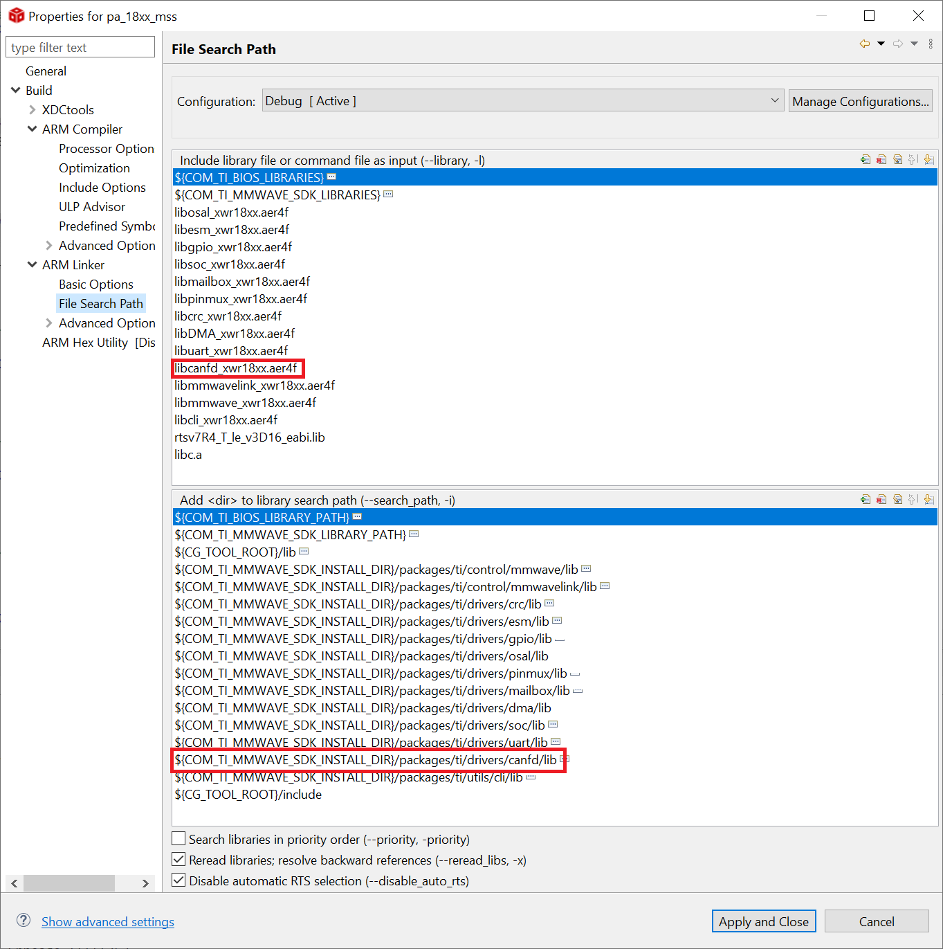

I want to apply CAN communication in the demo lab0008_automated_parking.
Refer to demo lab0007_mrr, I modified lab0008's mss_main.c. Also I added debug log in the
Can_Transmit_Schedule
as below:

Also I added library in build setting of ARM Linker as below:
Then I successfully rebuild the demo and run it in debug mode, but the CAN communications doesn't work. I tried both FD and Classic...
Below is the error code when I use CAN Classic, the retval and errcode are the same as that when use CAN FD.
