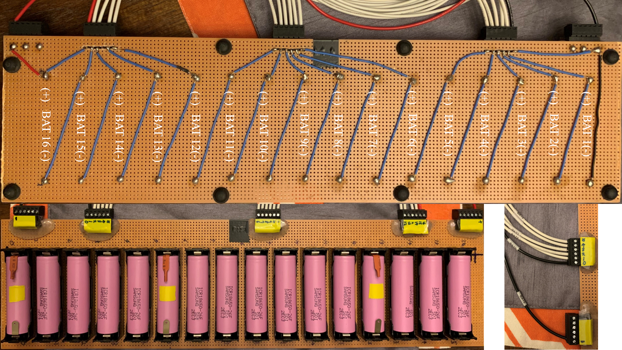

With the 16 batteries, I put 13 batteries as a normal cell which has 3.7V and 3 batteries as low SOC cell which has 3.5V

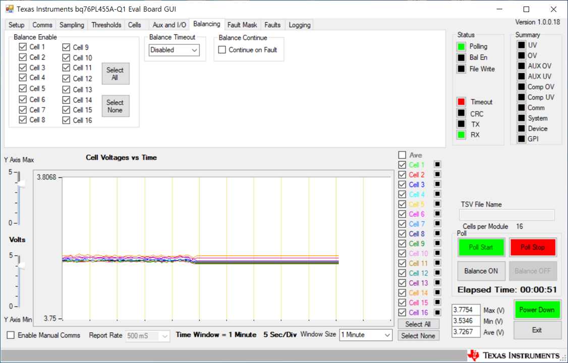

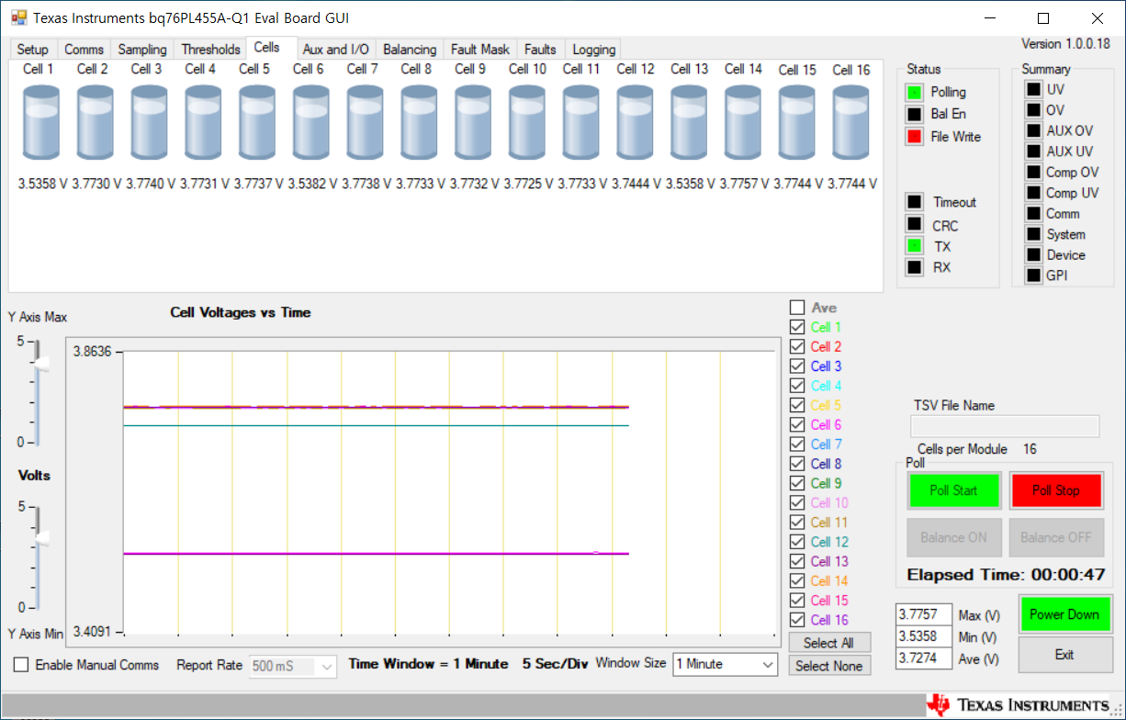

I click the Balance-on button at 25 sec. here is the result screenshot of normal cells.
here is the result screenshot of Low SOC cells.
Compare with the result from TIDUBI0, p16, P17, It is definitely wrong.

    It does appear from your images that balancing is occurring, but potentially from the wrong cells (depending on what you are setting in the GUI) and potentially the wrong current. Can you confirm if you have changed anything in the code?

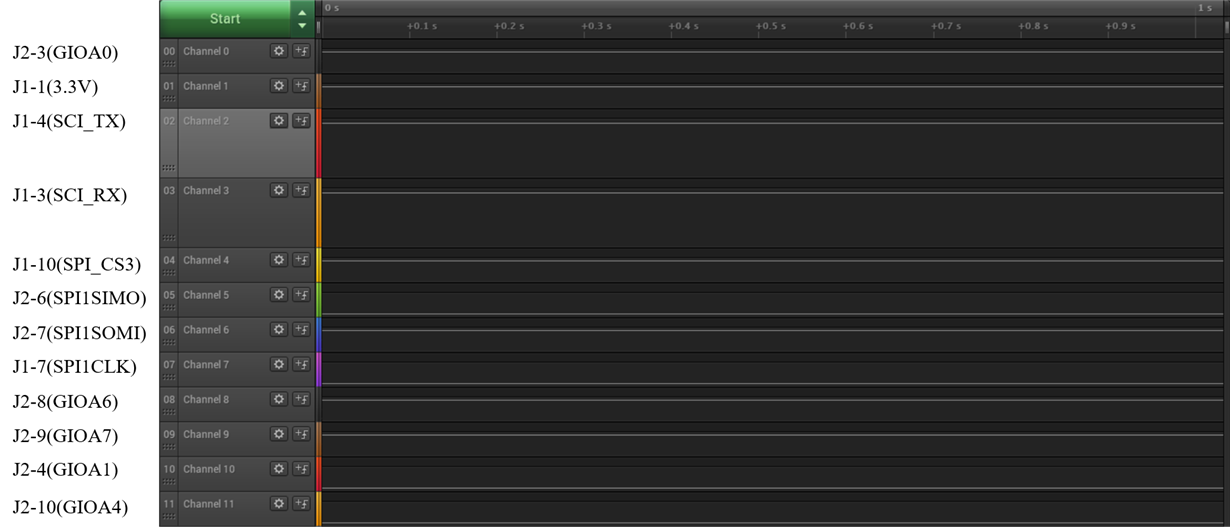

  • Thank you for the reply.
    Here is the waveform of the Logic analyzer
    After enter, click the Poll start :
    with Polling start, Balance On status.
    without clicking reset button on MCU Launchpad, It won't wok even polling.
    Thank you.
    The fact that the polling is not working while balancing suggests that something is going wrong with either the order of commands (polling first versus balancing first), or this is a different version of the GUI. Would you be able to confirm the download location you received this GUI from (what particular page)? Could you also provide the version number?

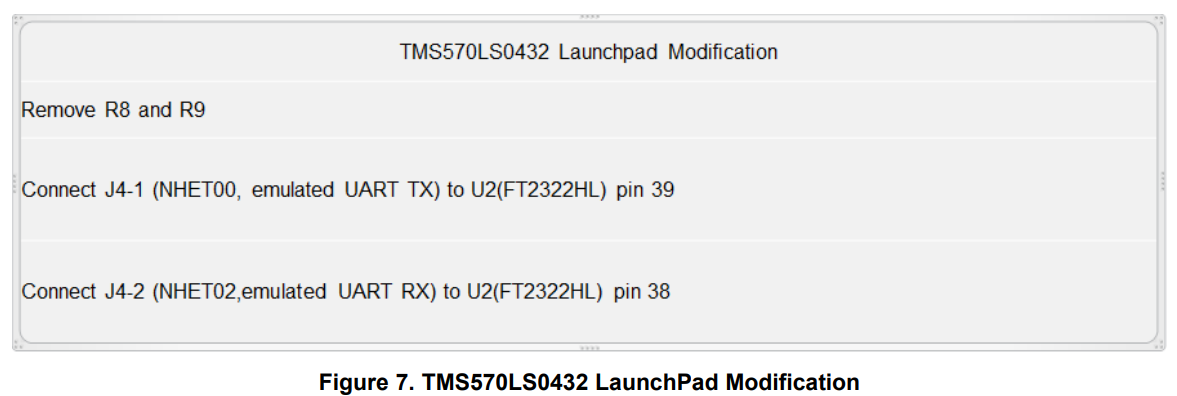

    Thanks for checking on this, as the correct GUI is essential to proper function as well. The software doesn't seem to be the issue here, but there does seem to be a lack of communication across the SPI lines, as shown in your previous screenshots, so please double check that Figure 6. is followed for connecting the connections (which you provided in your original post).
    Next, if there is still no signal on the SPI lines, please ensure that the following modifications from Figure 7. have occurred correctly (I believe you stated previously that you did correctly make these modifications, but I just want to double check):
    If these NHET connections are not made properly, then the code may never get to the SPI portion (which may be why there is no activity).
    Finally, if Figure 6. and Figure 7. are both correctly followed, and you still don't see any data coming out of the SPI lines in your device, we may need to dig into the cell connection setup you are utilizing.
    Please let me know what you see on the logic analyzer after the above two suggestions though, as I think they may help at least begin the SPI transmission.

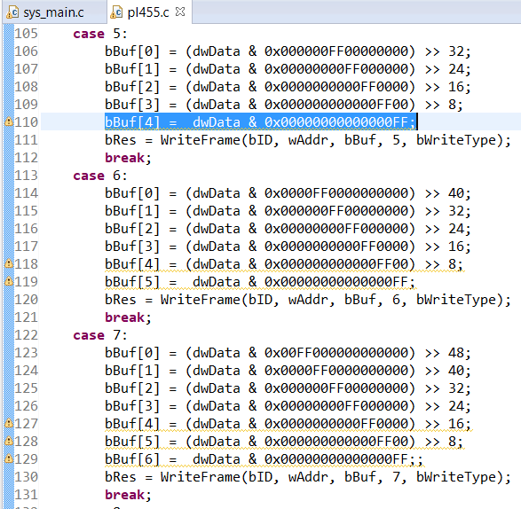

    I didn't keep an eye on the build warning.
    But I realize that I got lots of warnings.
    Could you check it is ok?
    Thank you.

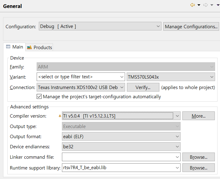

    Thanks for providing this! It looks like that the only concerning issues are the "subscript out of range" warnings. Could you provide the line numbers your compiler shows for the "subscript out of range" errors?
    Also, could you let us know what compiler version are you using (found by: right-click the project in Code Composer Studio->choose properties->"General" tab->look at the dropdown with the compiler version used)?

    As the previous post suggests, I double-checked, there is no difference.  No connection problem at all.
    For the latest post, the error came from below.
    And the compiler version perspective, I have used the below screenshot's version.
    I tried to use another version of the compiler which is 5.1.1 with the CCS V5, but in this case, the diode D10 is light on in red after debugging, the system cannot even enter the GUI.

    Thanks for the screenshots! It looks like the "subscript out of range" issue is actually fine, every single "WriteReg" call in the project uses 4 or less bytes, so those parts of the case statement will never be reached, and so it will never go out of range.
    The compiler version you are using should be fine too, so I would be surprised if that was the issue. Just in case though, let's try installing the closest compiler version to the original:
    Help->"Install Code Generation Compiler Tools..."->Search for ARM Compiler Tools Version 5.0.11
    This is the closest compiler available version to the desired 5.0.4.

  • Hello
    As you recommended, I installed the CCS 5.4.0 so that I can use the compiler version 5.0.4 exactly.
    With that compiler version, I got the same problem.
    Still, after balance On button clicked, the 'Timeout' tab turns into red light, all the GUI is frozen unless I reset the MCU.

    Thanks for trying this. I think the only possibility for the device to still be nonfunctional after starting balancing (assuming all of the previous requests are 100% correct) is an incorrect connection or POR event happening on the EM1402EVM. Can you scope plot the power rails of PL455 and EM1402 when you attempt to start balancing? It almost seems like the PL455 is being DRST by a power surge of some kind.
    Can you also ensure that the batteries are in series (not all in parallel)?

    2. Yes, I connected the battery as a followed picture.
    3. I think I have no idea which part should I fix more with this.
