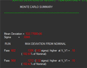

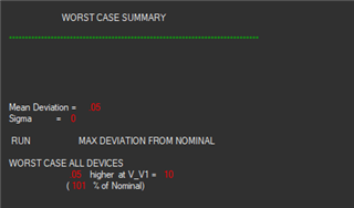

    Resistor model parameters: 1% defined for both resistors
    Worst case results: 1% is the deviation and that's true
    Montecarlo results: 2.65% deviation observed & it's not possible.
    I saved the parameters and tried to look into it. Pass 602 data is here
        R4                                      R5
    9.72158e-01          1.02511e+00
    Can clearly see, monte carlo is assigned tol of R4 to 2.28% & R5 to 2.5%. This is outside of limits specified.

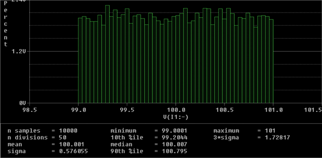

  • Hi Jaikumar,
    Please make sure that you selected uniform distribution in your sim profile. Gaussian is not bounded.

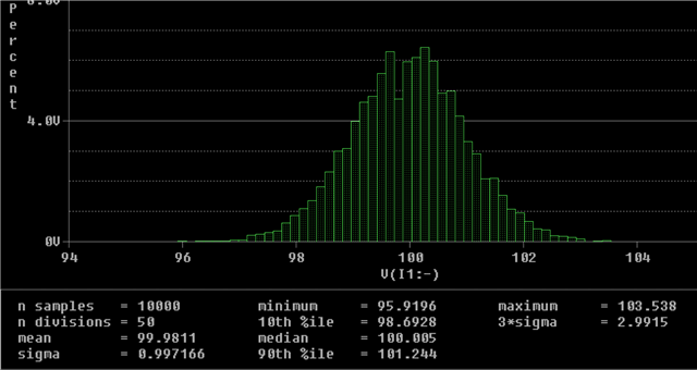

    This is a uniform distribution on a component with 1% tolerance. As you can see, all the samples fall inside [-1%, +1%} of the nominal value:
    This is the Gaussian distribution on a component with 1% tolerance. In other words, 1 sigma is 1% of the nominal value. As you can see in this histogram, some samples fall out of the +/- 3 sigma limits. This is expected with a Gaussian distribution:
