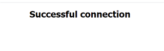

  • Dear Jackie Hom
    If you access ”">cdsplicwc.cadence.com/.../connection.html", Fig1 will be displayed.
    Is this result correct?
    And about "cdsPspiceTIlog.txt file", it will be as follows.
    Can you understand what is the cause from the following?
    After all firewall and / or anti-virus software seems to be a problem?
    Akihiko Yokouchi/

  • Dear Jackie Hom
    If you access "">pcb.cadence.com/.../TI_URLs.txt" (fig1), you can download "TI_URLs.txt". (fig2)
    But why does the download by "PSpice-For-TI_setup.exe" fail?
    Do you have anything to try?
    Please give me advice.
    Akihiko Yokouchi/
     fig1
     fig2
