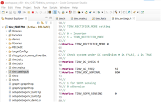

I just start developing TIDA-01606, this is not the 1st time 1 debug the program, i am using C2000 Launchpad TMS32F28379D, i compile build = 1 (open loop inverter mode)
the problem
1. The PWM (EPMW1,EPWM2, etc) register didn't updated especially the Compare Register and Timer Counter, seems the timer not configured properly or not triggered
I am using code that TI provided in TIDA-01606
I try debug the duty cyle via dummy variabel, i am confident that duty value cyle already there but its not translated to PWM hardware.

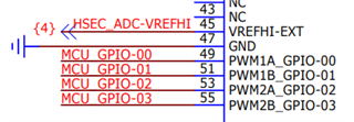

Please help, i also double check that PWM source pin was correct, the PWM pin should at GPIO 0~4 & GPIO 4~6 & GPIO 12~15 on schematic

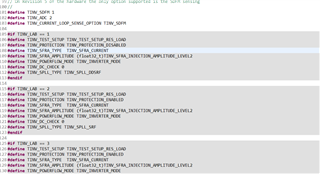

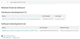

    I just found the source code on latest C2000Ware_DigitalPower_SDK_3_02_00_00as shown below, i was deceive by the old one C2000Ware_DigitalPower_SDK_1_03_00_00. but why TI still attached on their website "www.ti.com/.../TIDA-01606" TIDA-01606 Sofware and still can be downloaded
    code below the latest source code, devided into many Labs
    I measure on GPIO 0 & GPIO 1, etc in Lab 1 the PWM was properly functional
