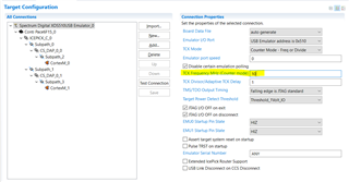

      Can you lower the TCK speed? Which debugger are you using? In CCS, you should be able to lower the TCK frequency. Will that make a difference?

      I have no experience with this board and neither IAR toolchain. If you use CCS and depend on which debug probe you use to connect to the target, there is option to change the TCK speed. See below for CCS on a different device where you can change the TCK frequency. The CCS also has utility to test the JTAG scan chain. I tend to believe IAR will have similar capabilities. However, you really need to reach out to IAR for this.
