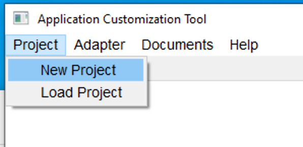

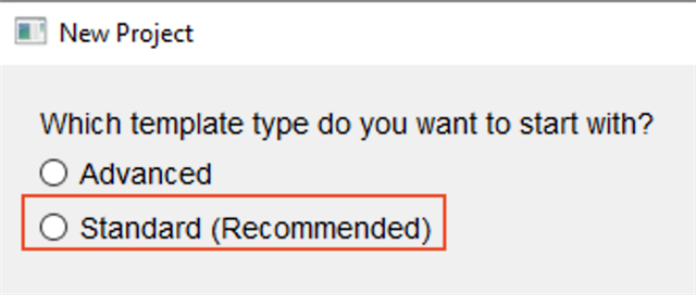

  • Rajat,
    Try out this process so we can establish a baseline and let me know the results:
    1. Launch the Application Customization Tool v6.1.2
    2. Go to Project -> New Project
    3. Select the TPS65981 device
    4. Select the Standard template option
    5. Select your desired port type option.
    6. Once complete the GUI will load the default template, preconfigured for the TPS65981.
    7. Go to Binary -> Flash from current project
    8. Change your USB Adapter to FTDI and then click OK to flash the device
    9. Unpower and reboot the device
    10. Once flashing and rebooting is complete you can check the status of the device by going to Adapter -> Configure I2C/SPI Adapter Settings
    11. Sweep the I2C address range to discover the device. Then test the Mode, Version, and Read registers to verify everything is working correctly. You should now be in APP mode and see that displayed in the Mode Register (0x03)
