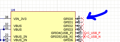

The schematic shows U4 pin 5 unconnected, but the layout has it connected to ground. This creates a DRC. Could you advise whether it should actually be connected to ground or not?
You can float the unused GPIO pins instead of connecting them to ground. They will be tolerant to this condition.
