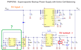

Hi Sir,
If adopt PMP9766 module and change VIN (Vmain) to 5V and Vout (Vsys) to close 5V.
Do we need to change the design of cell balancing operation (LP2998 in EVM board)?
Thanks!
Hello Ken,
as shown in the LP2998 functional block diagram (LP2998 Datasheet, page 11, chapter 8.2) the device regulates the Voltage at the VTT pin to 1/2 of the voltage applied to the VDDQ pin. Therefore, if you change Vin to 5V, VTT will be regulated to 2.5V and the capacitors will be perfectly balanced without any additional changes.
Björn
Hello Ken,
yes, as long as the capacitor stack has internal balancing which can keep up with the applied charging current, you do not need the LP2998 for balancing.
