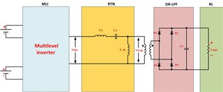

1-Could I use an LLC Resonant tank with a multilevel inverter as shown in the figure below? Or it is limited to use on half-bridge and full-bridge only.
2-If I use it with a multilevel, does it affect the waveform of the output of the inverter?
3-What is the output voltage waveform of the resonant tank (VLm)? Is it the same as the waveform of the output voltage of the inverter (Vinv) or different?
4-I am facing the problem of determining the proper value of the quality factor (Qe), so that I can find the values of the variables for the resonant tank (Lr, Cr, and Lm). Is there an appropriate way or tools to accurately determine Qe value?

  • Ali,
    LLC with TI's analog controller is basically for DCDC conversation, like 400Vdc to 12Vdc/24Vdc/48Vdc. we don't have reference design to show LLC in inverter.

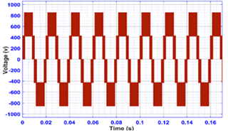

    In you image, what is the waveform of Vinv?
    Yunsheng

    the waveform of [Vinv] five-level 5-L as shown in the picture below.
  • Ali,
    1. TI's LLC controller is limited to be used only in half bridge or full bridge LLC, so it need Vinv is square waveform form 0 to Vin with very high switching frequency.
    2. TI has no analog LLC controller can support multilevel inverter, so we cannot answer your question.
    Yunsheng
