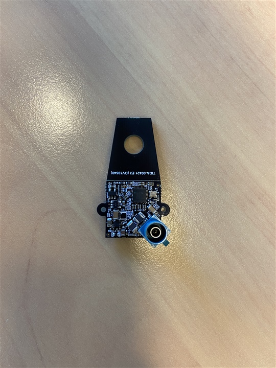

    Also while I'm here, could you upload a font/back photo of the TIDA-00421 board so I can see the connections and such? Thank you.
  • Hello Taylor,
    Yes I tried the driver inside the ov10640, but it's for MIPI connection and not DVP.
    The TI DS90UB913A supports only DVP configuration so the sensor cannot be in MIPI, that's why. Could you please check this issue ?
    Here below the photos front and back of the TIDA-00421:
