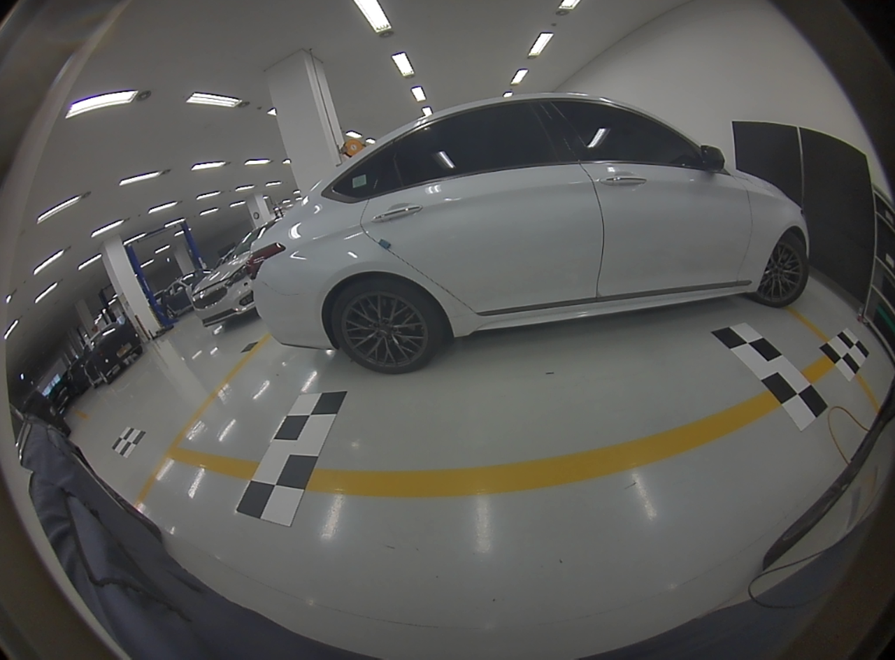

Is it possible to create an application for testing tivxVpacLdcNode() on PC Emulation mode without VISS
Part Number: TD4VM
I am trying to correct rear image from camera. After studying TIOVX I concluded that for correction I need Perspective view created by LDC.
I cannot run "single camera VPAC application" on target board due to some constraints and that application does not support LDC on PC emulation mode (as mentioned on the website).
Can I create a simple application for testing tivxVpacLdcNode() on PC Emulation mode without VISS.
What should be the format of input image in that case?
Can I use same LUT table given in single camera VPAC application if my image is of the same size?
I want to correct the following image:
https://1drv.ms/u/s!Al0MAu0Ttb431W6mqDorlmZYsQ3a?e=bbEeNU
I want to transform it into the same way you have corrected fish eyes images in Mesh LDC Sample Images (J7/TDA4 ISP) page 82 like below
https://1drv.ms/u/s!Al0MAu0Ttb431Wtu9CkVf28sGOx8
