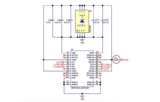

What is the task of L3 in the following illustration? Is it dispensable?
Thank You
Thank You
Hussein,
L3 is used as a low pass filter to reduce EMC and other RF emissions in the system.
