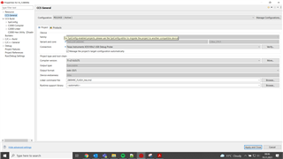

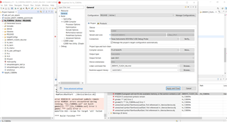

I'm building a LLC resonant converter and found a reference design for it on TI, design is TIDA-010062. In this design TMS320F280049 is used but in product's main page under the products title there are suitable TI products and I can see 4 different MCU families. I've choosen TMS320F280041 among them. When I try to reach reference design's code on CCS I can't change the device on "variant and core" section(it's locked, I've attached a ss). Is there any way to change the MCU on this screen? Because I was planning to use this code on TMS320F280041. By the way I've used some other reference designs and this is the first time that I can't change the MCU on that page.
