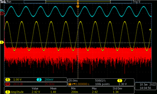

I using the exact TIDA-00777 reference design in real-time for the current measurement, but there is a huge noise in the output of the integrator ( photo attached to this msg, Yellow-output|| Orgage is the FFT of the output)
Could you please share your results if the output is noisy as well?

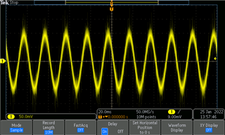

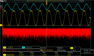

    I've uploaded 2 oscilloscope images from J1 and J4 for the precision measurement and fast settling paths. In both images, the blue trace (channel 2) is the input to the TIDA-00777 PCB from a function generator set to a 0.1V amplitude, 50 Hz sine wave and the yellow trace (channel 1) is the output. I also turned on the FFT math function of my oscilloscope as well. Note that the precision measurement output is clipped due to the default gain and DC offset of the TIDA-00777 design.
    Do you have a function generator to use as an input to the circuit to start debugging where your noise is coming from? Can you probe multiple points along the signal path to see if the noise is coming from a specific amplifier stage? Can you share your schematic that you've implemented?

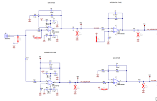

    I have used the exact same circuit designed in TIDA-00777
    Changes Done:- The supply for - OPA2188AID is 3.3V
    Here is the Schematic
