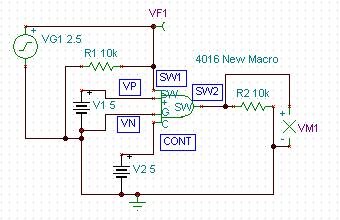

Good Morning,
Where can I get a model for TINA-TI of a 4066 or equivalent and/or a model of the OPA211-HT that I can run in LTSpice?

  • To John Miller
    John,
    I did mean the CD4066  or any quad switch you might have.  I found A Pspice model of a 4016 and successfully built a new model  (not pretty but works) but I can't find where to change the name 4016 New Macro to 4016.  When I copy it into another schematic it changes to U6 New Macro.  I tried to insert the .TSC but got a File Type Not Valid message.  How do I send a TSC  if needed?
    A tweak would be better than what I have now for the OPA211-HT and I would appreciate it
    Thanks again
  • Steve,
    I believe you establish the name when you are using the New Macro Wizard.  Chainging things once you have created the macro and symbol is a little daunting.
    From your message it seems that you wnat to be able to place a part and have it labelled as "U# 4016", Is this correct?
    If you can upload what you have I can take a look at it.
