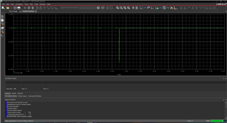

What is the source that would provide the 12V output? The independent source goes to 40V and drops back to 0. I don't see how this would work. It does not look like a simulation issue.
I don't know sir.. because in TINA-TI we can run the simulation smoothly and we don't need to put resistor to our schematic. we just need to click 'Zero Initial Values' when we want to running our transient and Boom it works..

Skip initial transient bias point won't fix floating node problems. Please share your project that demonstrates the issue.
BTW, you have 2 pages under schematic1 but they seem to be unrelated:
All pages under the same schematic are simulated together so please don't put unrelated circuits under the same schematic.
Anyway, I run the simulation but did not run into the N17262 and N17258 floating problem.

You can press ctrl+f and search the nets:
They don't have DC path so you cannot caluclate the voltages. Please replace the caps with 2 50nF.

I've already change the capacitor but it's still produce an error
this only can be solve by putting a bigger resistor, that's why i'm asking you why we need to put that and what if we don't want to use that ?
and you said last time to use "skip initial transient bias" but it still didn't work
i'm asking you "WHY", I'm very desperate too right now because this issue already passed my goals

No. What I asked was to replace the 2 100nF cap in series with a single 50n:
